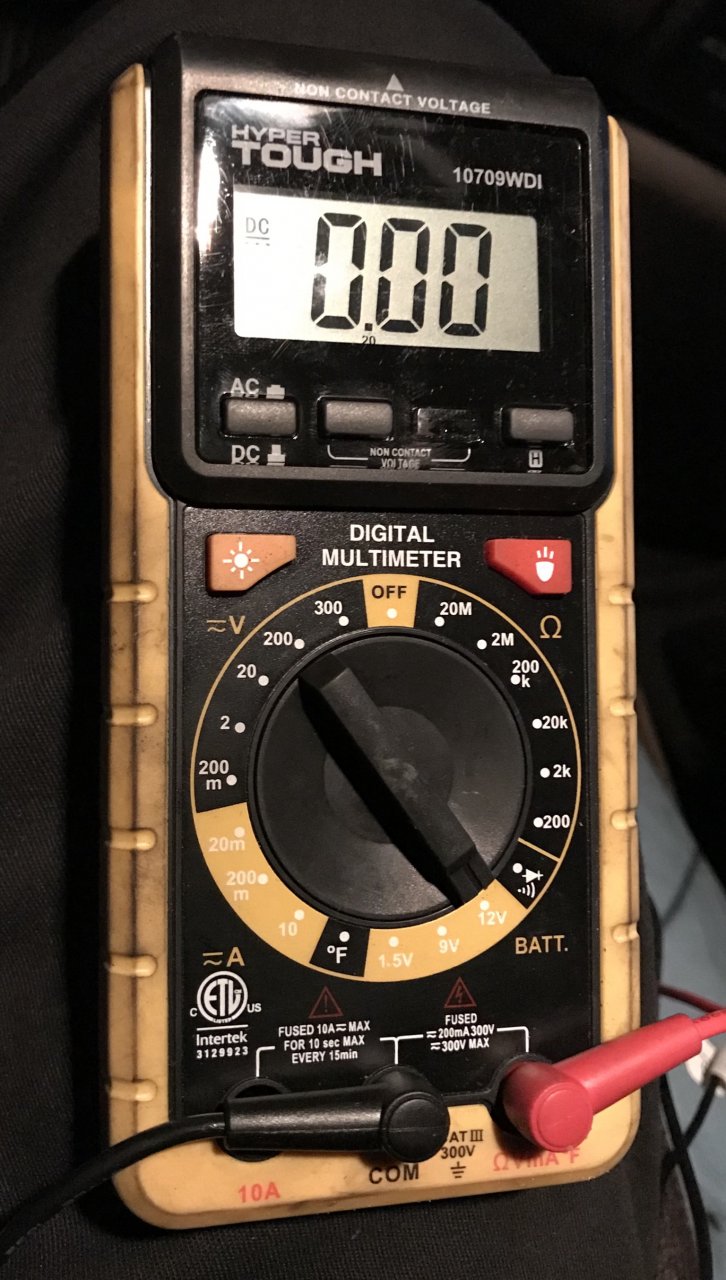

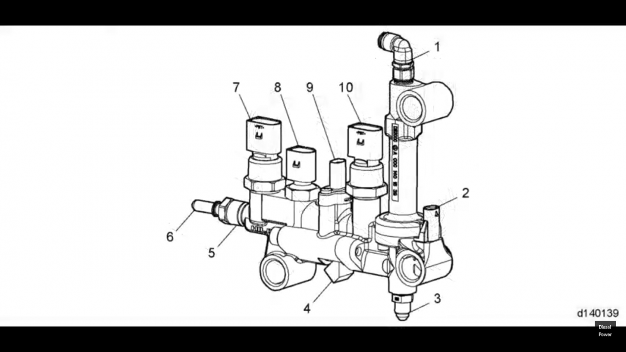

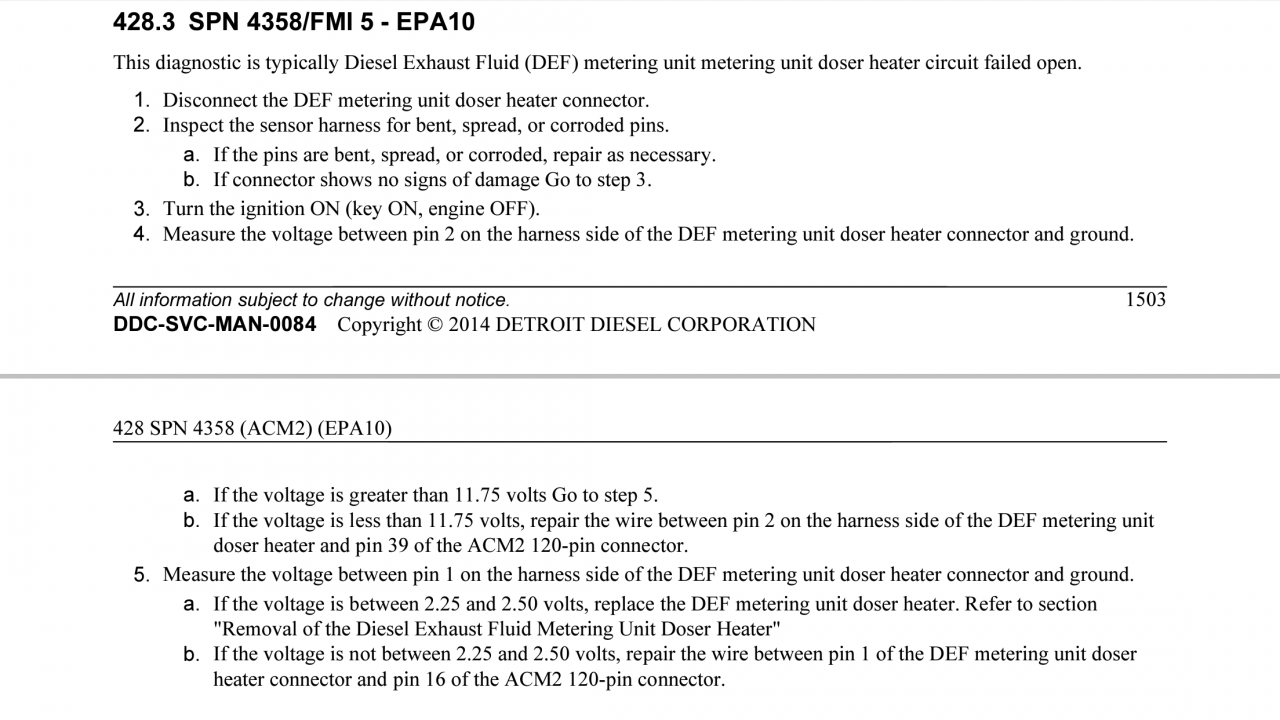

    I’m a bit new to using a multimeter. Assuming I am using it correctly, it is showing 3.36 volts for the dosing valve (#4 in the image). Also, step #4a says it needs to be over 11.75 volts? If so, then the wire is apparently partially corroded?
    It’s confusing using a multimeter. I am selecting the option for battery and 12 volts, and it seems to work.

    I had the wrong instructions. I now uploaded the correct one for my truck (EPA10).

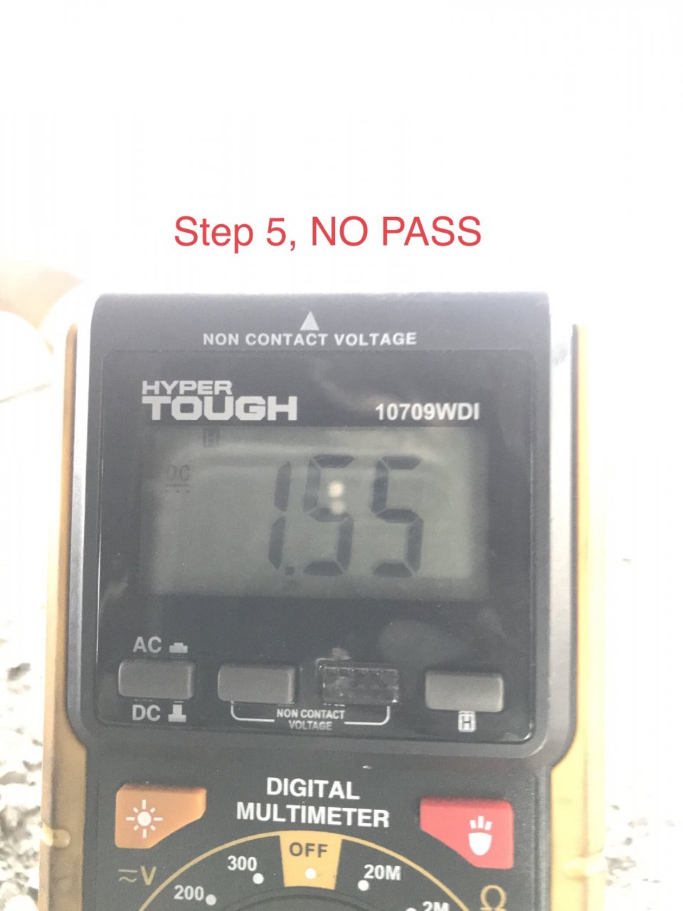

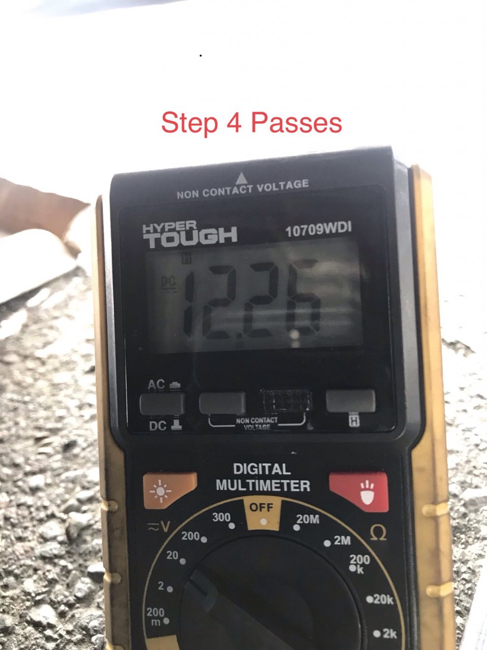

    Ok, I finally learned how to use a multimeter. Step 4 passes with a 12.8 voltage. Step 5b does not pass. It shows a 2.59 voltage. It’s strange how the voltage is higher than it’s supposed to be. How is this even possible? What kind of wire damage will make the voltage rise instead of lower?

    I’m guessing alittle here, but I’m betting it’s “bleeding” over from a higher voltage source from corrosion bridging.
    So look for green, you’ll hopefully find it in a plug you can just clean out or you’ll find a spot in the harness where the wires and road debri have rubbed the insulation off the wires. If your lucky the wash job you just had will have washed some of it out so you can see a trail of green (corrosion) coming out of the harness or plug. But I’ve only been this lucky a couple times.
    This is a problem you’ll want to find. Running new wires will fix it temporarily, but what ever is bleeding over will more than like rear it’s ugly head down the road and you’ll have to find it then anyway....

    The “ground” wire on ECM monitored circuits is sometimes not a normal ground, but is routed back to the ECM and can have a small voltage on it. This allows the computer to distinguish between a wire problem on either side of the circuit.

    I grounded the multimeter to a negative post on my truck batteries, and then tested each of the two pins on the doser valve (or heater) connector.
    Do you happen to know why Detroit’s instructions are saying the voltage should be between 2.25 and 2.50 volts for step 5, instead of just saying over 2.50 volts like on the previous step 4?

    I finally fixed this problem. To start, I was checking the wrong connector! This code is for #9 in the images posted in this thread, and it’s known as the DEF metering unit “heater.” Pin 1 of the heater connector (step 5) did not pass a continuity test to pin 16 of the ACM2 120-pin connector. In other words, there is a broken/corroded wire.
