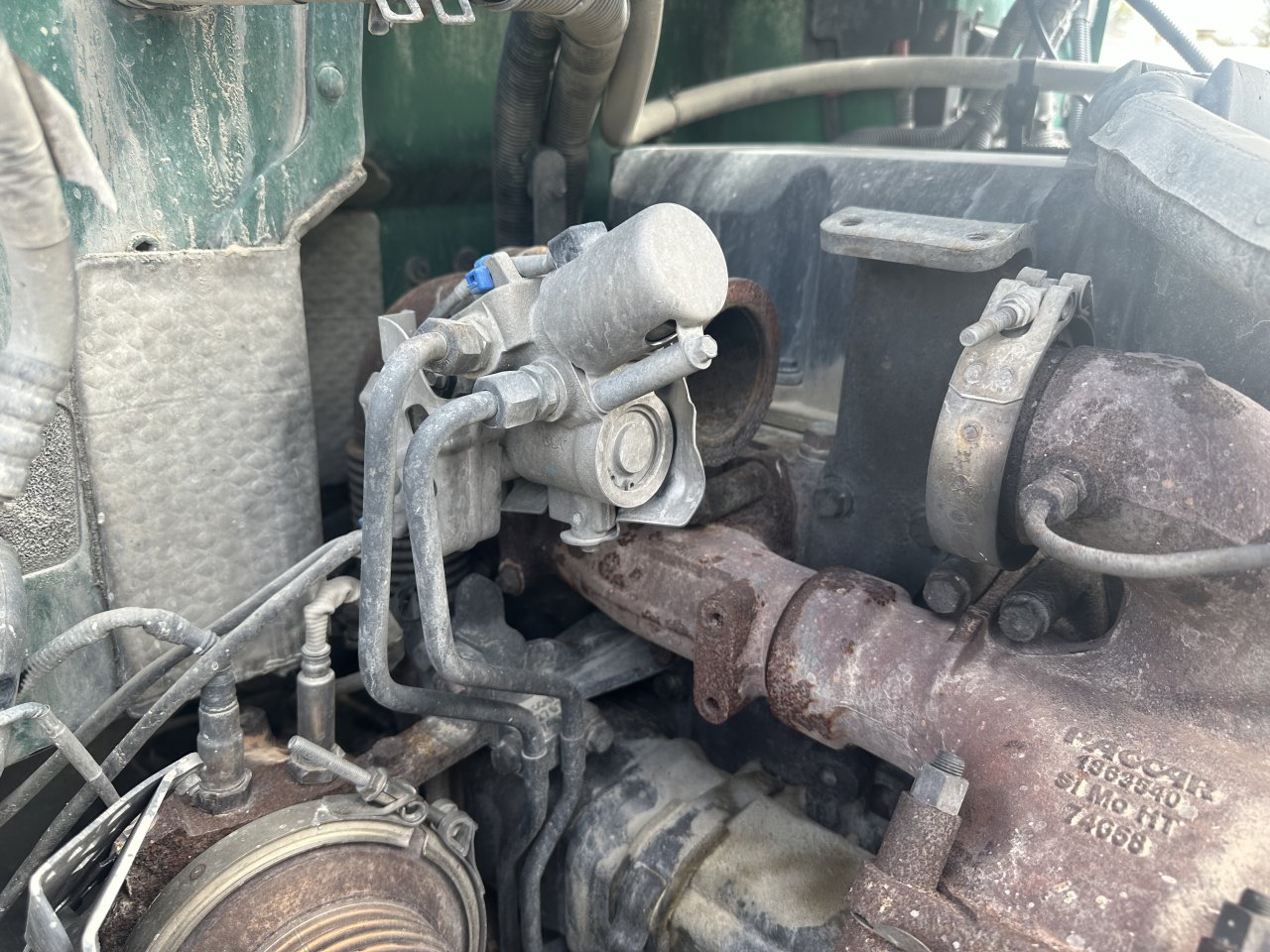

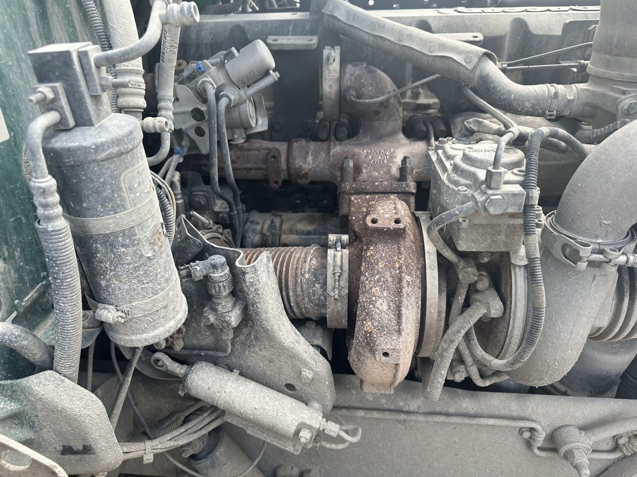

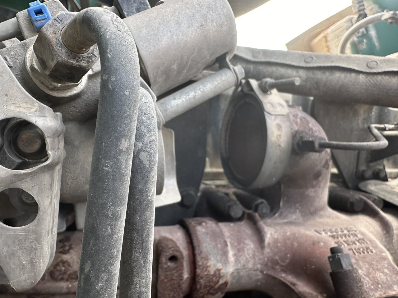

    It’s cool, I haven’t worked in a couple days due to wonderful spring rains but I did snap a couple pictures for ya.
    But after talking to my mechanics today, I’m not sure what they’re gonna be able to do at this point other than someday taking it to a Peterbilt dealer because now, supposedly, the mobile mechanic my boss knows who has a laptop with the proper software who can do things to these newer trucks said he can’t get into the computer now so I don’t know what the hell I’m gonna do.
    But here’s those pics. As you can see in the picture, that part that I showed you in the other pictures that has the block plate in it, that just comes right down into the exhaust manifold.
  3. Icanfixit
    Icanfixit Bobtail Member
    21
    8
    Dec 21, 2023
    Minnesota
    That is where the bellows between the egr valve and egr cooler goes.
    Egr valve is mounted to exhaust manifold.
    I'm not sure what to tell you about the bpv. The factory trucks don't like it when that is disconnected. The ones I have seen tuned still have that connected, right or wrong.
    Arctic_fox Thanks this.

    So what do you mean when you say the factory trucks don’t like the back pressure valve disconnected being that my truck really isn’t factory anymore being that it’s deleted? What does that BPV even do? After the truck was deleted, I’m not even so sure that cylinder that works the BPV even works but even if it was still operational, when does it activate? Is it supposed to help with boost? Act as a waste gate?

    See if exhaust pressure before turbine sensor tube is plugged.

    Bpv will help the engine warm up by creating back pressure and holding more heat in the engine. This is needed by egr, during regens or cold engine operation. This valve also helps with engine braking.
    I have had the actuator stuck closed and it acts like turbo does nothing cause the engine can't breathe.
