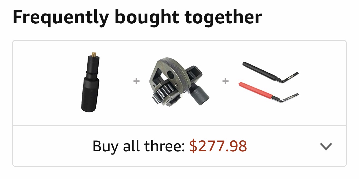

    you will need a timing pin. It's $65 on ebay.

  10. PE_T
    PE_T Road Train Member
    Can you show me how the timing tool looks? I have a DD15 engine. I’ve never used such a tool. Is it to rotate a metal wheel to a particular spot? What’s the purpose behind it?
    It looks like I’ll need a timing pin and also a barring tool?

    it's not a timing tool it's a set for valve adjustment tools the part is called engine barring tool. there is a window on gear case housing. it must be installed there with two bolts. by using 3/4 drive ratchet you turn flywheel until engine is on tdc. You can turn the engine by big flat screwdriver too but it will be slow.
    What you want to do ? valve adjustment ?
    look at this video he has OM tools
