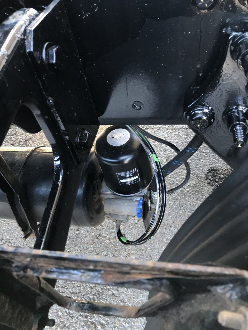

  10. PE_T
    PE_T Road Train Member
    Yes, my air compressor has an air dryer located in the back of my cab and mounted behind one of my air tanks, possibly the primary air tank. I remember there was some oily gunk coming out of the purge valve early this year, but I didn’t know what was going on nor did the Petro mechanic know.
