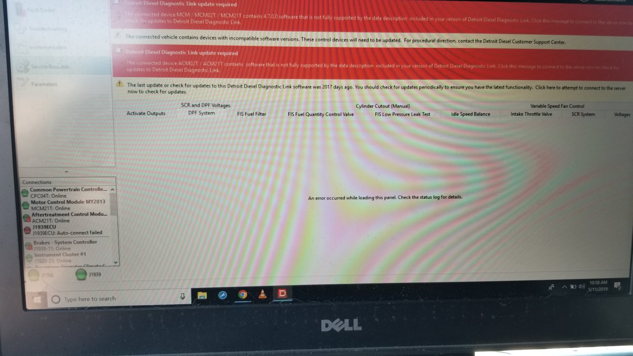

  7. PermanentTourist
    PermanentTourist Heavy Load Member
    749
    881
    Nov 9, 2016
    48 states + Canada
    Ok, the sensor is dangling freely in the air.
    Now the next problem...
    My DDDL is weird and obsolete, it won't let me do a force regen through the computer.
    I guess all I can do is let it warm up and run a button regen and see what happens. Unless there is some sneaky way to force a regen with this old software. It's weird, it shows me all the data from the one box, but doesn't let me talk to it.

  9. Dave_in_AZ
    59,317
    411,571
    You don't suppose where it says the last update you did was 2017 days ago has anything to do with it do you?
  10. PermanentTourist
    749
    881
    Nov 9, 2016
    48 states + Canada
    The fact that I bought it on Amazon for 50 bucks from some weird Lithuanians might also be a contributing factor

  11. mhyn
    mhyn Road Train Member
    4,255
    4,515
    Dec 29, 2008
    Northridge, CA
    your software is very old and hacked... Will not work for sure if you are unable to start parked regen by using software..
