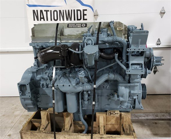

    1999 Detroit 12.7 Series 60 used engine for sale . 500 HP, Serial # 06R0568768 . Tested and inspected with warranty. Call or visit website for more info! $5500
    Rideandrepair Thanks this.
