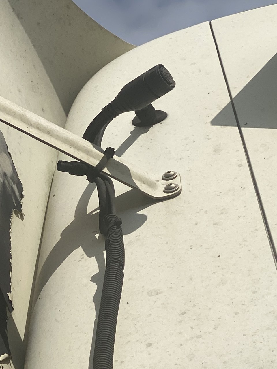

    check upper rear driver side of cab for old qualcomm wiring left over from previous owner.units get removed when not needed,but wiring stays.wiring still tied into datalink.if you have wiring still there,climb up back of cab and look in connector.gonna have green corrosion inside.quick fix is to cut connector off.proper fix is to remove all old wiring.good luck.p.s.also change aux pdm,cheap insurance if you do not know if it has been changed yet.20 minute job.

    Wow. You’re absolutely right, about the old Qualcomm harness! I had the same exact problem, where truck wouldn’t shut off with the key, and left side of dash gages not working with key on. I’ve been bobtailing and pulling chassis in winter slush. Sure enough: Qualcomm plug on the outside of bunk had corrosion inside. As soon as I cut it off, truck shut off! All gages started working, when stated the truck! Will remove the old harness completely, next.
    Thank you so much for the tip!!

    Yes. Those are the symptoms. Follow the steps that I outlined in previous post.

    Properly remove the whole wiring harness inside and outside the truck. Cutting that harness is an emergency, get out of trouble solution.
