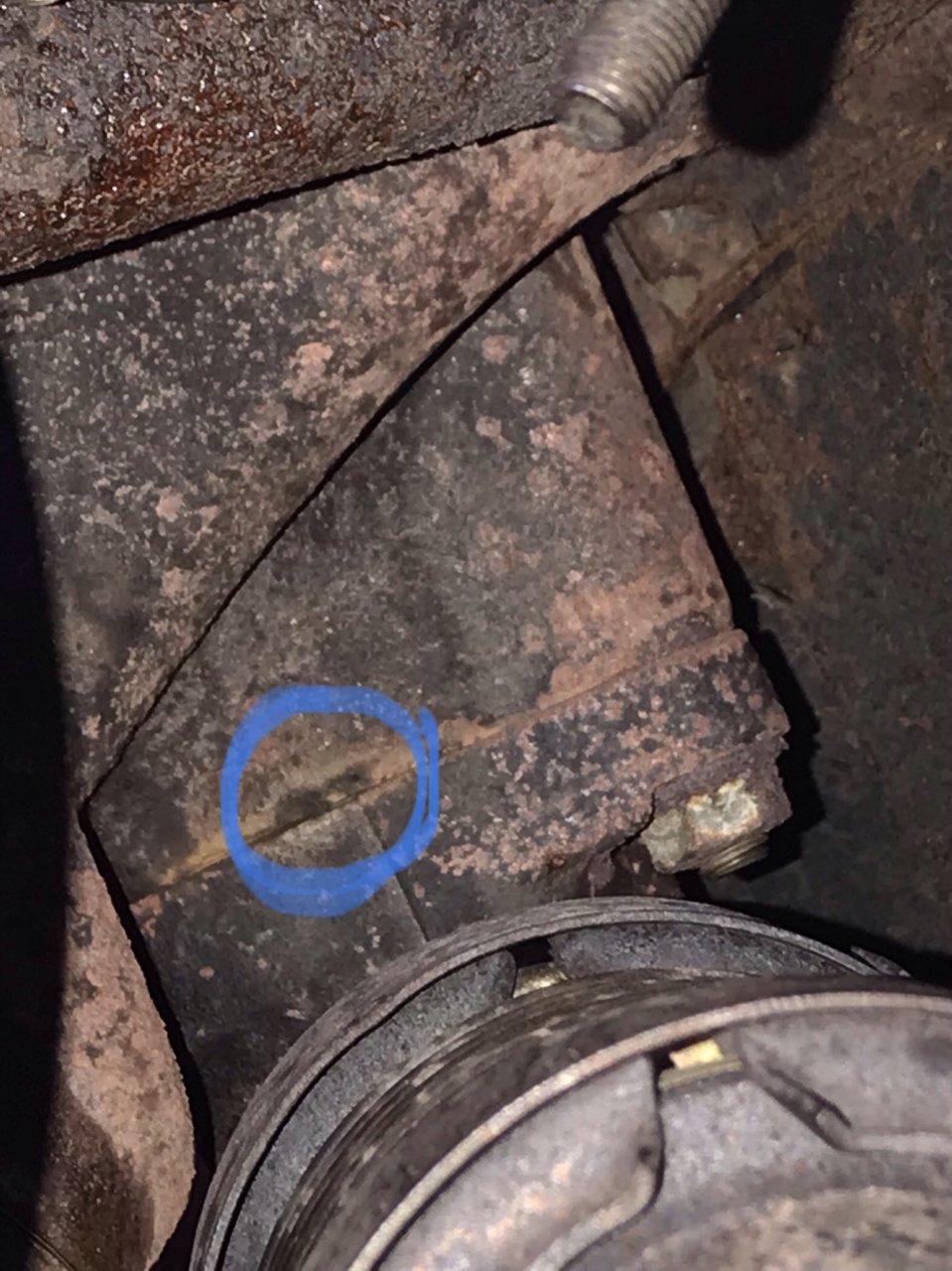

    finally was able to upload some videos!!

    Yeah. You will get zero results unless you do a pressure test.

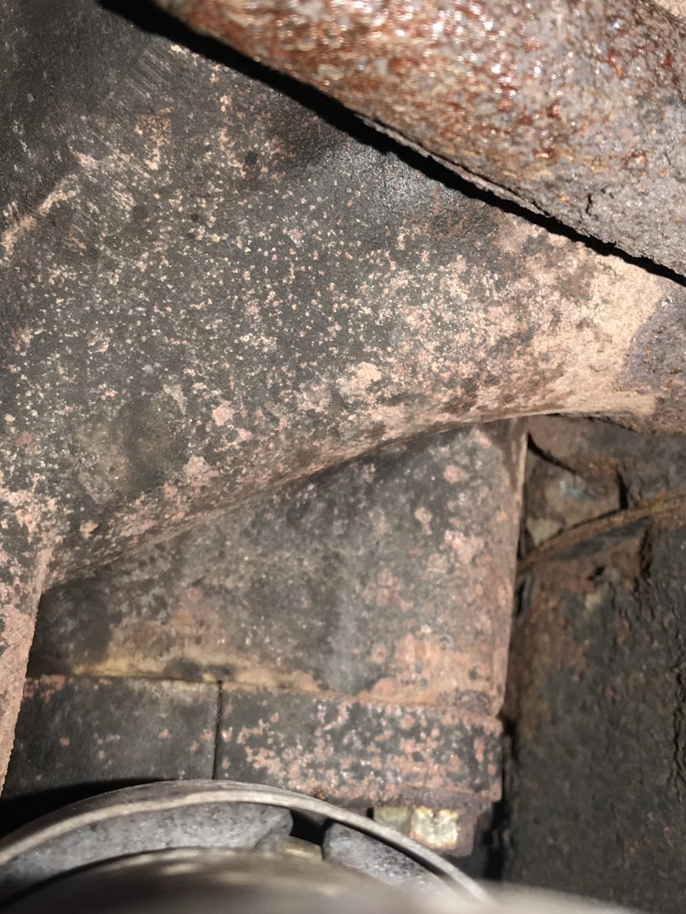

    did do the pressure test today. Didn't find any leaks.

    Yeah just saw your videos. You buy the turbo locally? I would be taking it off and returning it for a replacement. But I know it’s not that easy when your truck can’t afford to be down another day

    What you can do right now is pull the intake hose off and spin the impeller to make sure it’s not hitting the housing and check freeplay

    Little leaks like that absolutely will not create that turbo issue you are having there

    Yes turbo was from westernstar dealership.
    I Did check the impeller.its not touching the housing.spins freely..and it had very little play.i’m guessing Thats normal??
