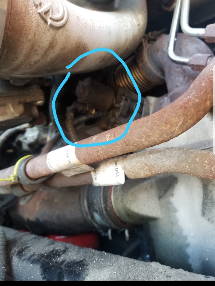

found it I just going to put some jb weld and seal it since I did the egr delete but it was leaking a lot of oil good idea or not?
