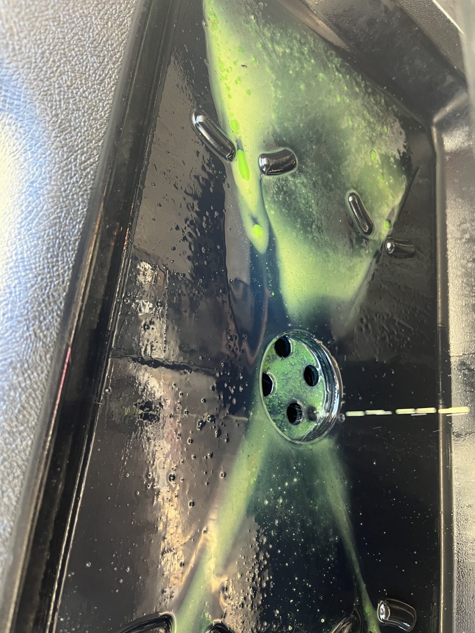

    This is what mine looked like when I drained my fuel tanks during rebuild. I had all the same symptoms.

  7. JoeyJunk
    JoeyJunk Road Train Member
    8,744
    67,723
    Dec 31, 2010
    Washington, PA
    I assume it was injector cups. I was getting a rebuild anyways……this just sped up the decision. My old engine wasn’t tore apart as I was rebuilding a different block. I am currently in a legal battle with the engine rebuilder so I probably will never know any specifics of my old engine.
