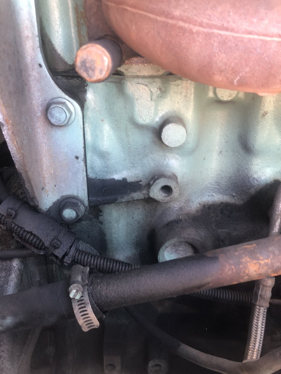

    C8FC2913-DC66-4D9E-9316-78DD438160A9.jpeg Watch along the head gasket on passenger side rear especially. Right below the exhaust manifold. Also watch for oil leaking around exhaust gasket, and oil going towards the turbo. Mine was blowing oil into exhaust pipe, The valve guides were so bad the valves were slapping 3 of the six pistons.

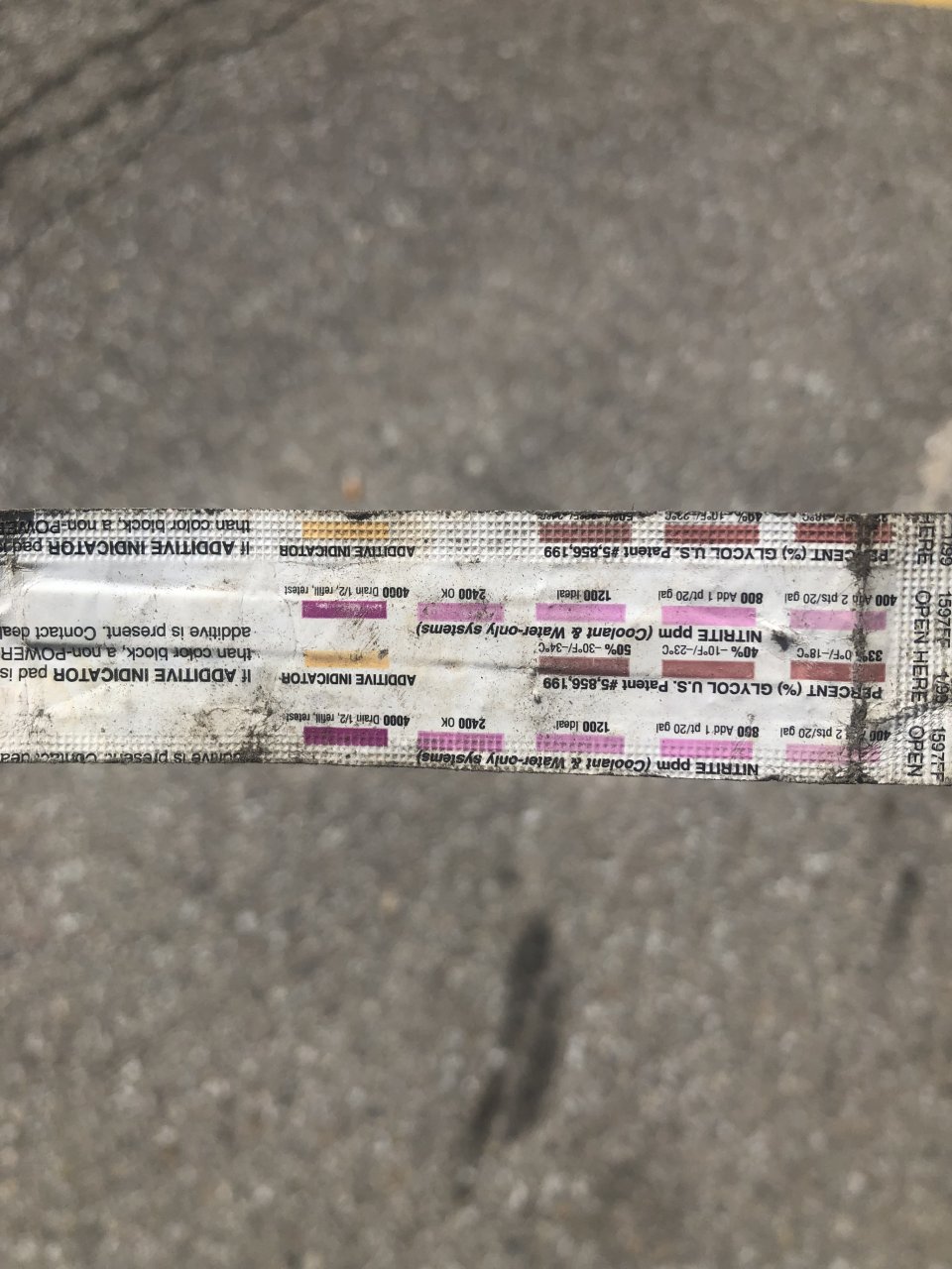

    6E88D256-93E0-4271-BE60-095CC97E4954.jpeg These strips are used to test coolant. Very cheap insurance. They have a shelf life. No need to buy a lot at a time. Check as part of normal pm oil change. Add pencil or equivalent to achievie proper color on strip. Ideally test strip matches reading for 2400 too Little or too much additive causes problems. Pre mixed Red Final charge has additives already. Still have to check and add as needed. Sometimes only once a year or longer. Best to test, to make sure.
