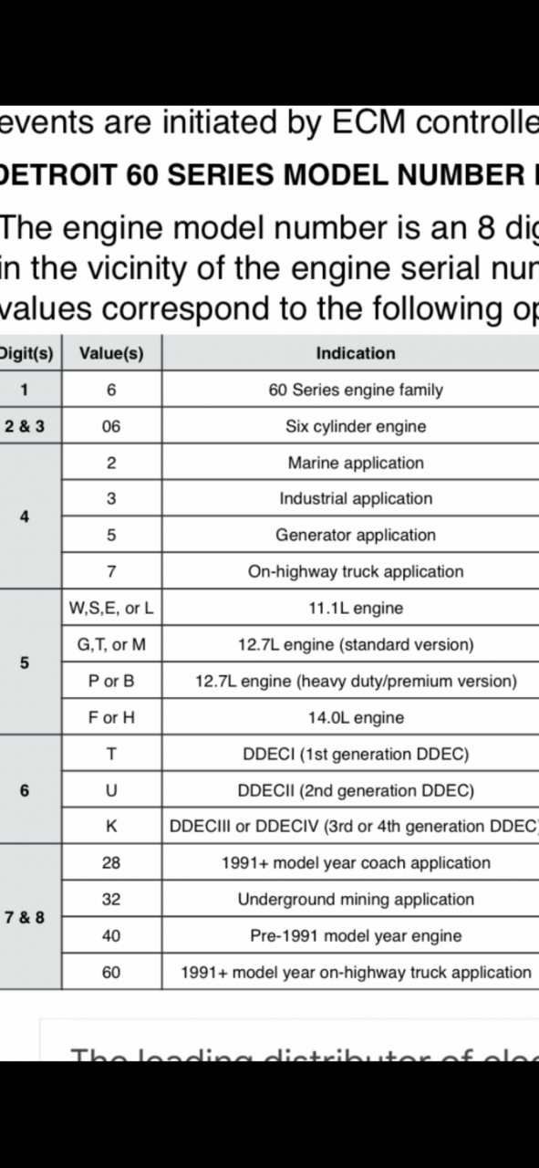

  3. Rideandrepair
    17,284
    56,105
    Aug 8, 2015
    E3B45DB5-C23B-44DD-B1E5-C6D7846472FC.png Don’t see anything ending in 45. Should end in 60. @benjamin260_6 is an expert on Detroits. Maybe he’ll chime in. Full serial # might help get build date. M code usually means no cooling nozzles. Easy upgrade. PK (1998) has 15:1 pistons. BK (1999) has 16.5:1 pistons, and usually 7650 injectors. They’re 9 hole instead of 6 hole. Finer spray for better atomization. Along with pistons, fixed the white smoke on start up problems that the older ones had after an OH, and the required lonox programming.

  4. DDguy
    DDguy Light Load Member
    157
    101
    Apr 21, 2020
    Ont. Canada
    45 Designates Fire truck engine 60 designates On hyway truck engines not a huge diffrence physically other then some accesories are placed Diffrent
