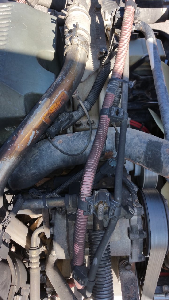

    I'm waiting for the mechanic to show up to replace the EGR. Since the last oil change it's used very little oil. About two weeks ago I replaced the elbow leading to the turbocharger.
    Last night bobtailing back home I still had some issues with power loss and surge, but not nearly as bad as under load.
    This morning the oil was at the fill line, down about 1/2 from fill to topped out, all that in a day.
    I noticed soot all over the area in front of the turbo. Comments welcome. 20160220_111825.jpg

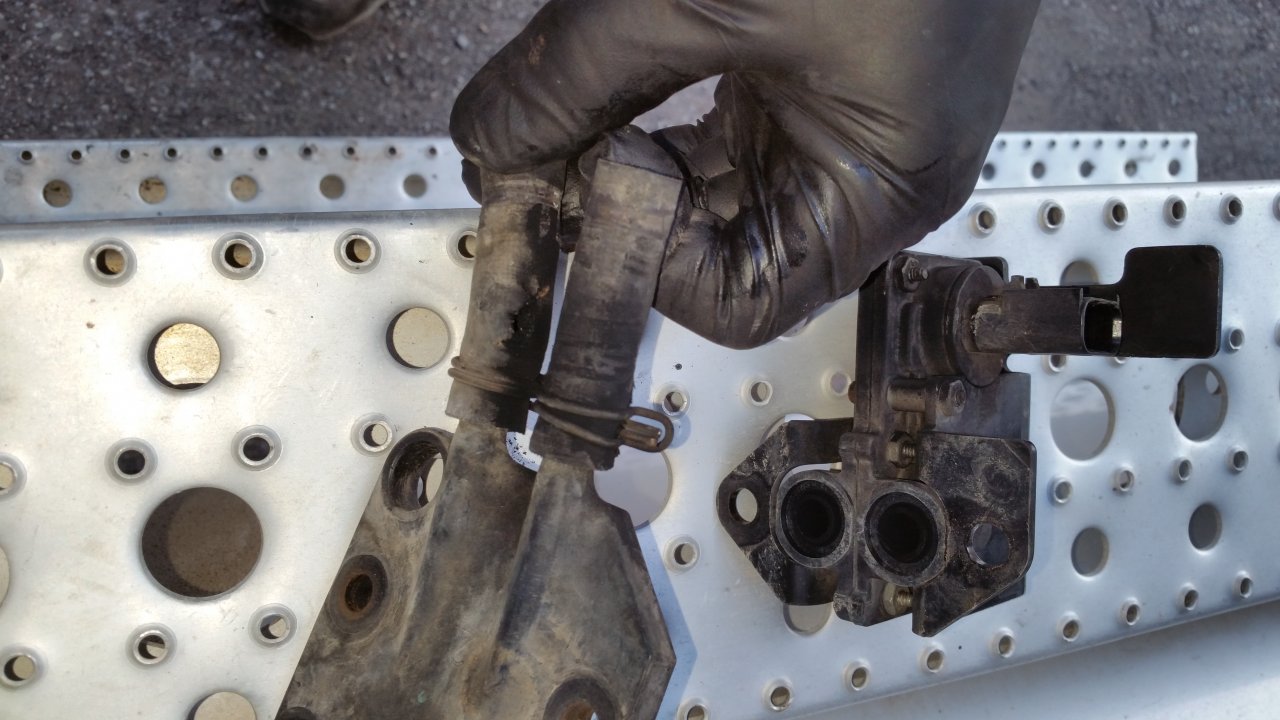

    Under the turbo and Turbo Actuator there has been a slight oil leak. Now this area is worse. 20160220_115704.jpg

    Mechanic finished the work and I had a chance to run it bobtail. Smooth idle now. I can feel a smoother transition of power from 1100 to 1500, used to really lage and kick in weakly around 1300.
    EGR was not replaced. He replaced the Delta Pressure Sensor. One of the hoses had blown a hole, which created the soot on top of the engine.
    He also took out the Turbo Actuator, cleaned it, and put in a new gasket and O-rings. That should take care of the oil leak under the turbo. He asked me to call him after I've had a chance to pull a heavy load, so he can adjust the actuator. He thought by eyeballing it the stop bolt was too long, preventing full power and the arm adjustment may need to lengthen a tad. 20160221_180035.jpg 20160221_175850.jpg

    I can't answer whether the Turbo Actuator is the same as a vpod, nor tell you how much it cost for repairs. The owner of the truck hired a local mechanic to come out and take care of it. I watched as he explained what he was doing. As soon as he saw the soot on top of the engine he honed in on the Delta Air Pressure Sensor and found the blown hose I have pictured above. The hose blew because the sensor was shot.
    He took the turbo actuator off, took it apart, and thoroughly cleaned it before reassembling with new gasket and o-rings. Then he adjusted it to factory spec (it was 3/4 turn out).
