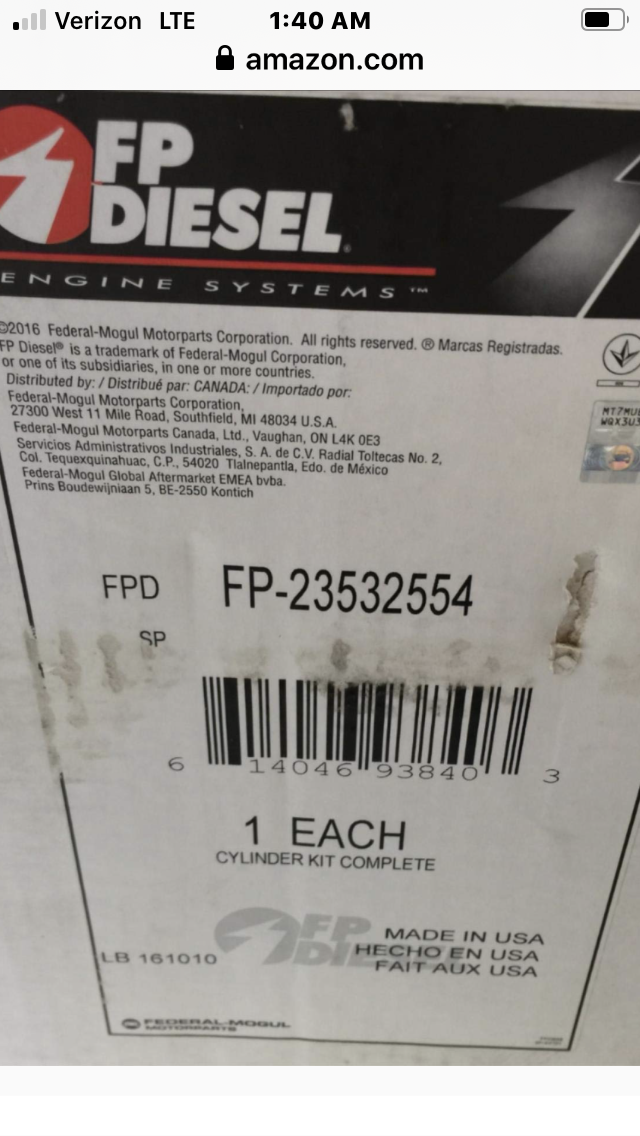

    I used the FP ( Federal Mogul) Kit, pistons are made in USA. Mahle makes the originals for Detroit. They do have Plants in China.
    tommymonza Thanks this.
  9. Rideandrepair
    17,337
    56,255
    Aug 8, 2015
    1EEA8F5C-1D2D-428B-95A1-5C52BE37DE76.png Time will tell, seems to be a good kit. Price was also the best, from M&D distributers Houston Tx. $1900, free shipping.Heres an example, of a piston kit I found, says made in USA
