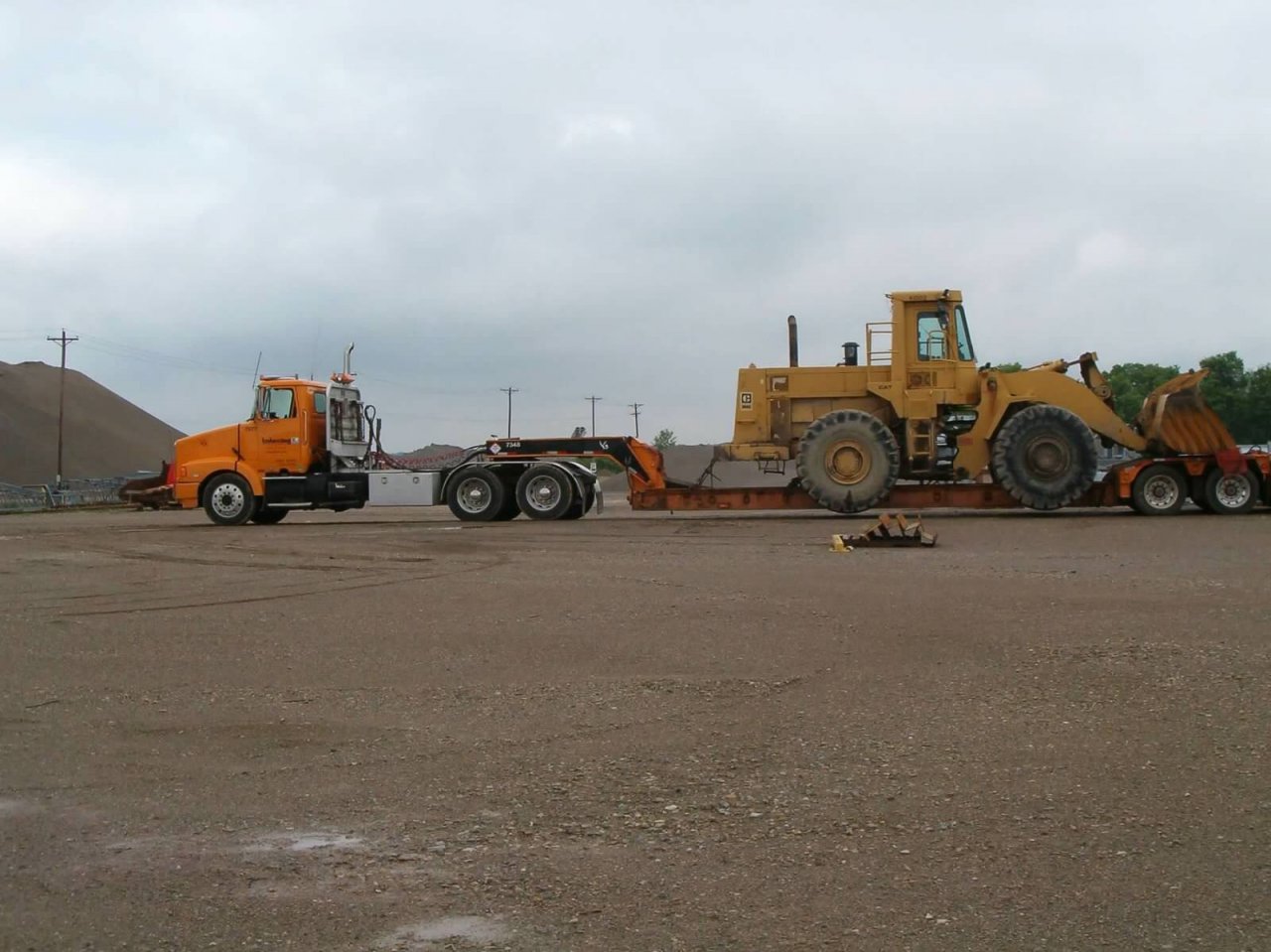

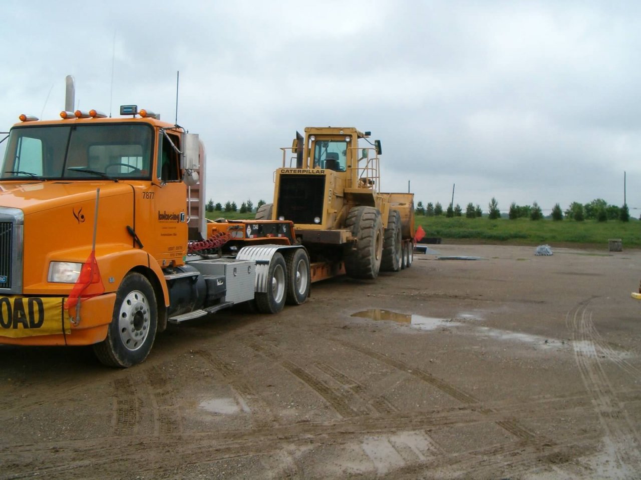

    Ehh, not ideal? Whatever. This truck was a 425 Cat 3:70 40,000 rears with a 15 speed. Their whole fleet was speced that way at the time. It obviously has deep reduction but the steps between gears were similar to a 13 speed. I hauled a lot of loads with it, soft job sites are just as bad if not worse than steep grades and that truck ran 600,000 miles. A truck doesn’t have to have the heaviest everything available to do the job.
