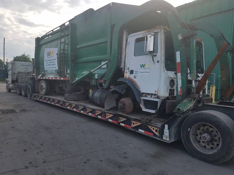

    You mean like this guy?
    wore out, cke, snowman_w900 and 2 others Thank this.

    Look here’s all I’m saying, if I speced a new truck it would have heavy rears, an 18, decent horsepower, etc etc etc. but some like to pretend that the only thing that’ll hold up grossing over 80,000 is a prime mover. Go to any major metro area and spend a few days looking around. You’ll see small company after small company that has an ex fleet truck pulling heavy loads. The OP like many before him asked a simple question and the simple answer is yes it will. He might get into it and find it’s not for him, then he might get into it and find it is and get a better truck. I just get tired of people acting like it’s that complicated.
    loudtom, beastr123, wore out and 7 others Thank this.
