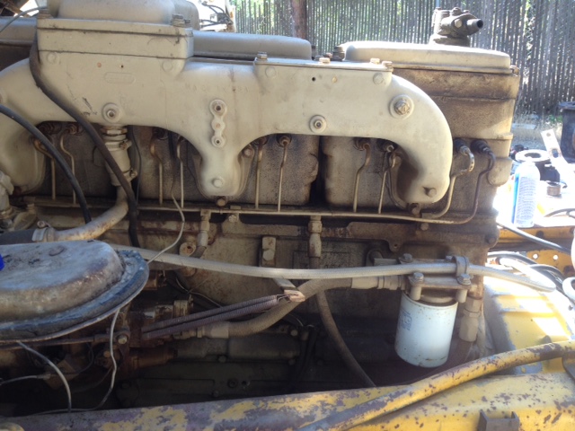

    @flc120, heres the engine you need for that truck.

    @truckdad what is that motor?? i see 4 injection lines per head

    @damutt, from the left side it is a Cummins 262 (a 5 1/8" bore, 743 cu in, 220 with a turbo) However, on the other side is a blower drive, large oil cooler & oil cooled piston sprayers. This engine is dated 1964 & was originally a NHRS 320. At some time somebody removed the blower & put on a T-50 turbo. The co. I work for aquired this from a wrecking yard & was going to put the engine in a water truck destined for auction. I talked them out of that after convincing them it is quite rare in that only about 1 in 100 of these 320s had oil cooled pistons. It IS for sale....
