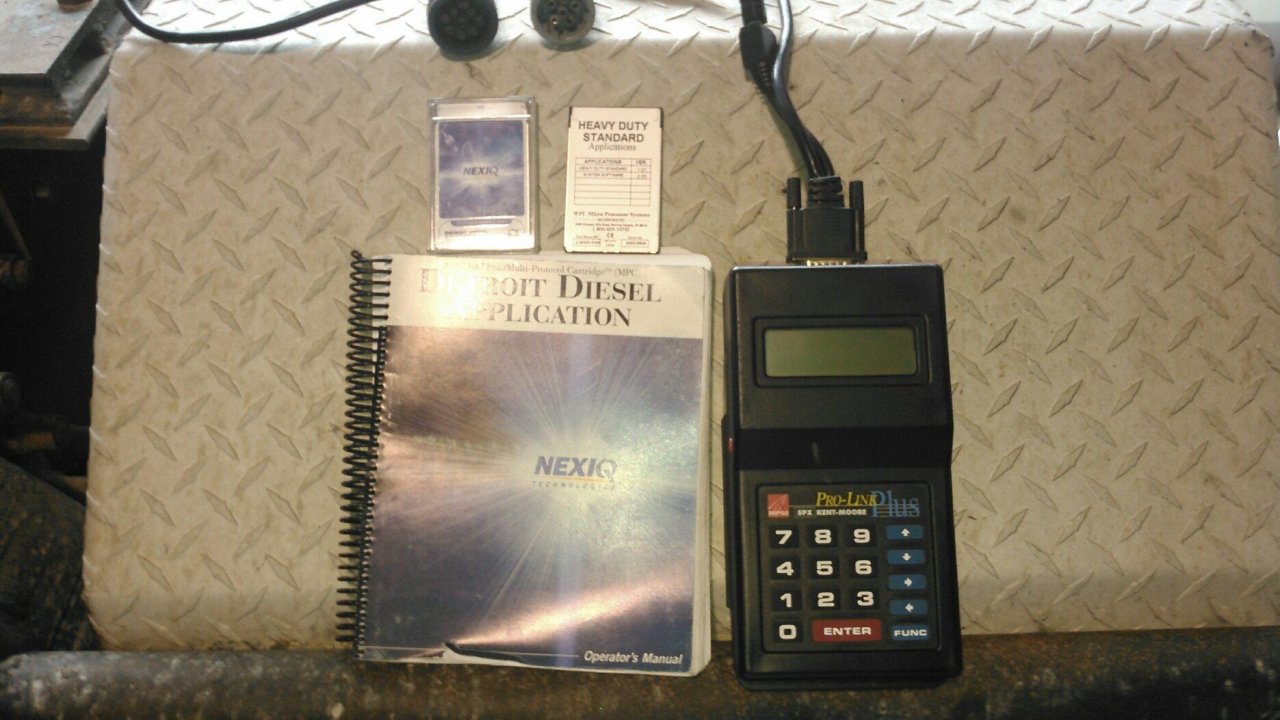

    The next step is a scanner. It will plug into the diagnostic connector like this one. KIMG1315 (1).jpeg

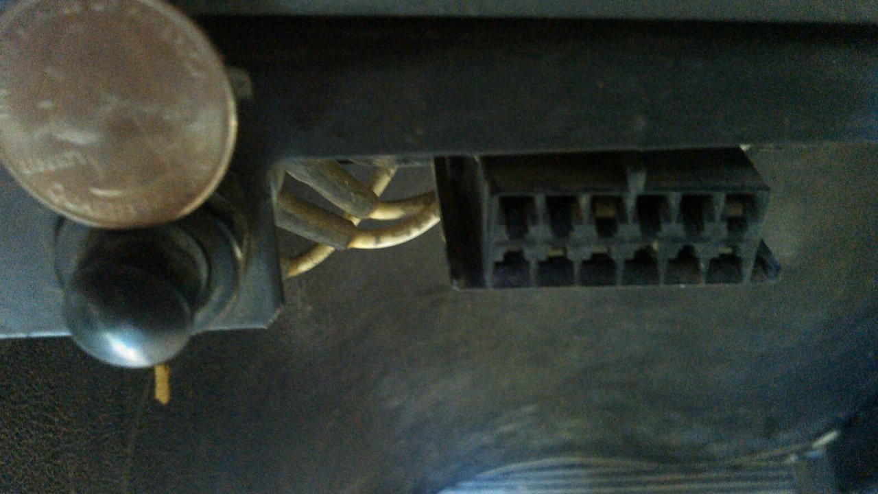

    Connectors at the top are 6 and 9 pin Deutsch plugs. If you have an early model it could have a connector like this KIMG1215.jpeg Looks kind of like an OBD II but it is not. That connector would probably be hard to find and require installing one of the other connectors on the vehicle.
    There are others that will do the job and I thank this ones was sold with different name brands. You can buy them on E bay.
    The white card is heavy duty diesel and it will read codes on most engines.
    The blue card is Detroit Diesel DDEC 3&4. There is another one for 1&2. A third one for five. With those cards injector tests and a lot more can be done. That is old technology like your engine.
    Then skip any of that in between stuff and go to the Nexiq IQ with a laptop. That is just to the best of my understanding and knowledge.
