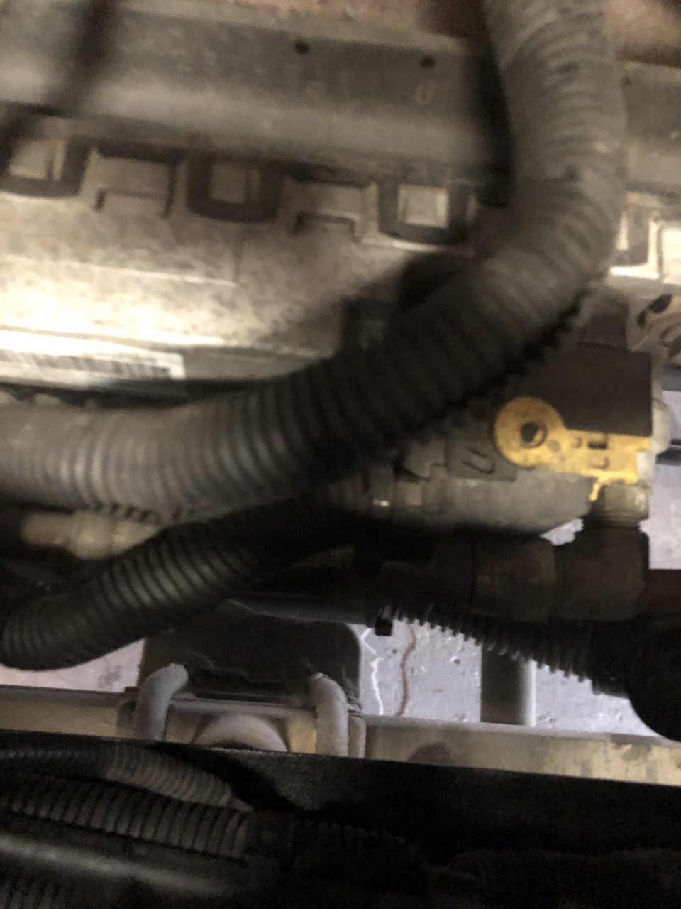

    Here is a video on the location. It's almost on the block under intake.

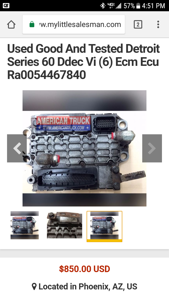

    I think you have a ddec 5 ecm.
    Pictured is a DDEC VI (6) rpm.

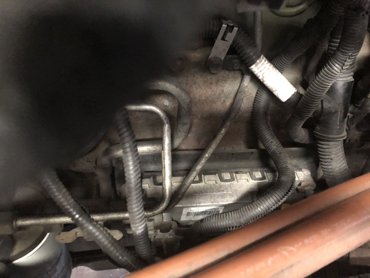

    Double checked with image it’s a DDEC 6

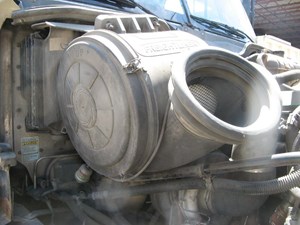

    That's odd. I figured all ddec 6 had flat air filter on top of engine.

    This is the air filter.
