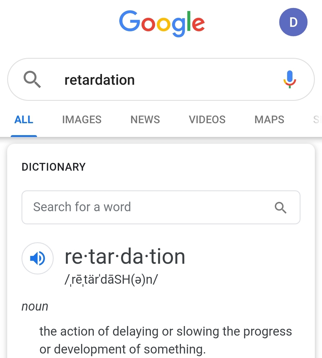

  7. swaan
    swaan Road Train Member
    2,942
    4,374
    Jul 12, 2009
    BC canada
    Maybe this will help.
    Rideandrepair Thanks this.

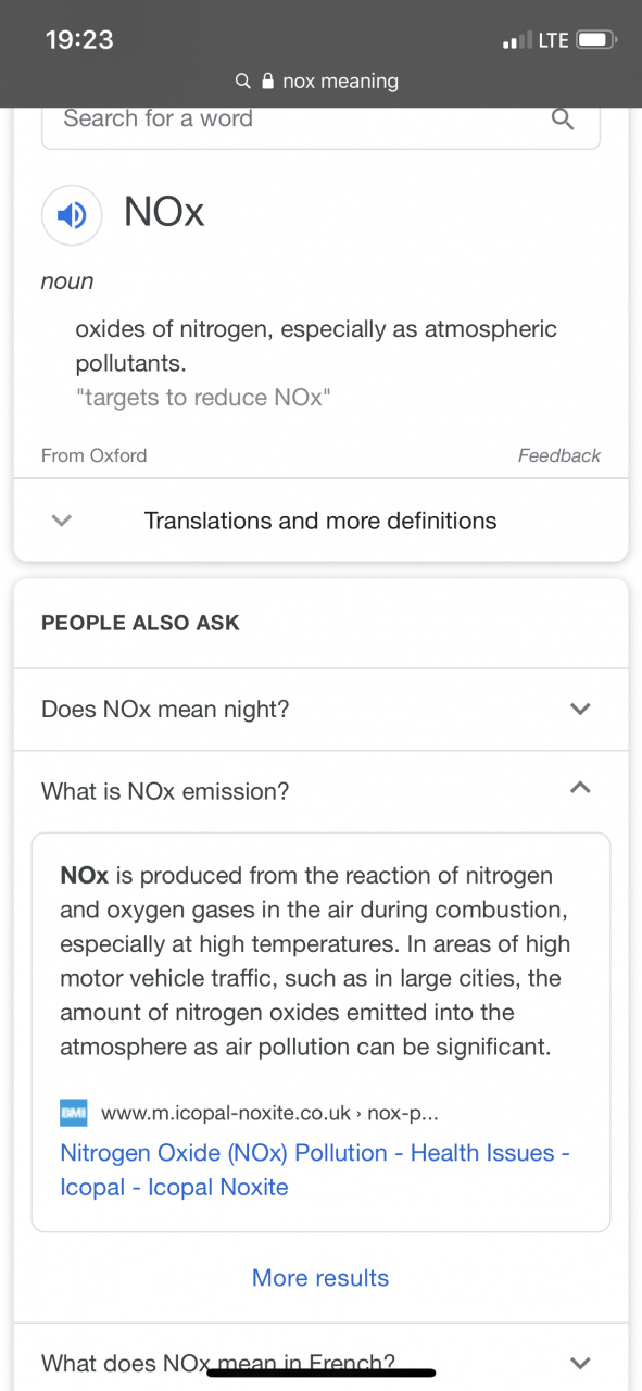

    Higher burn temp means higher NOx emissions.
  10. jamespmack
    20,033
    216,319
    That link means nothing beside higher ambient temps.
    You should read before posting.
