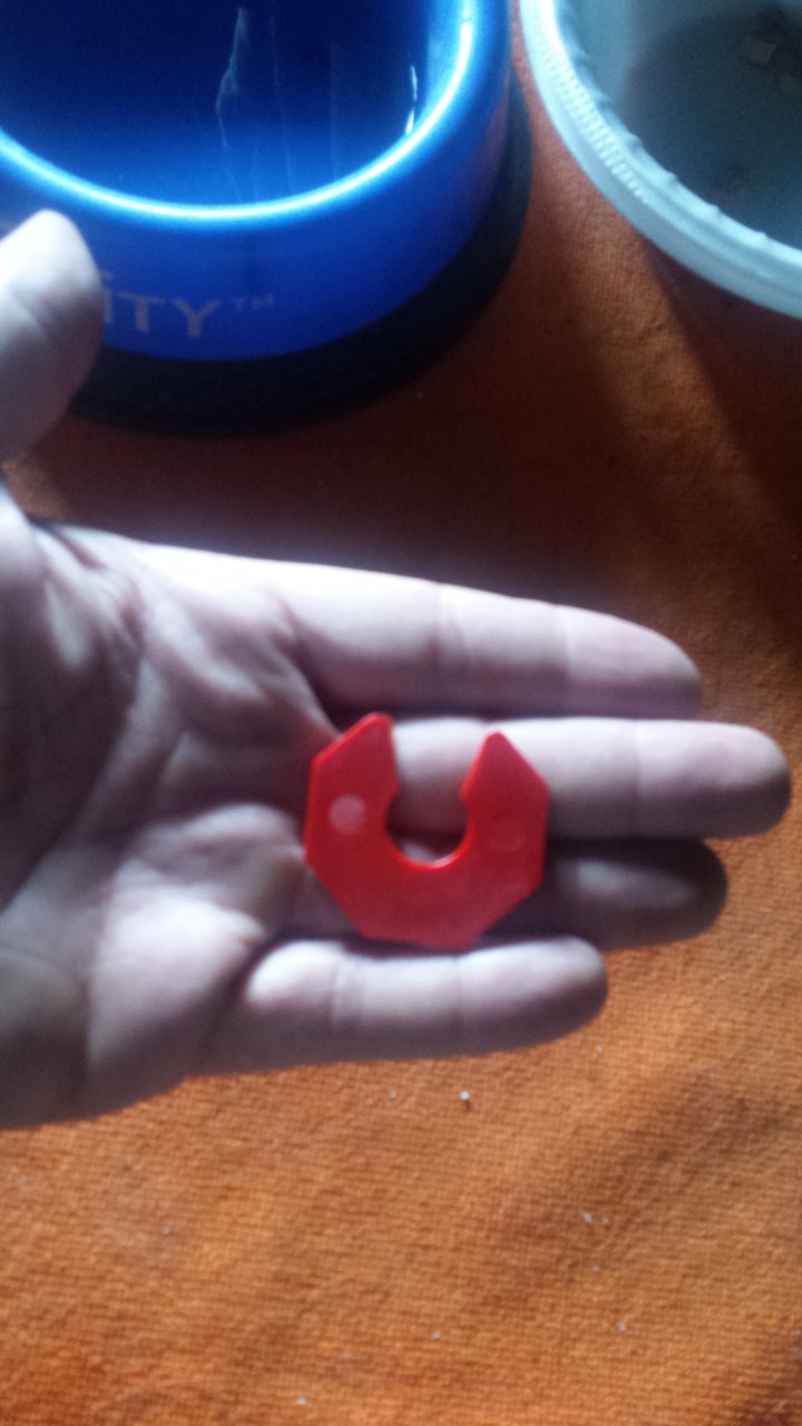

    They have little plastic markers you clip on your rods. Push brake pedal. Apply park brake. Then you can go measure them.
    As far as when to adjust them, when you hear that little voice.
    If I'm heavy, or I've been heavy for like 3 trips, and been on the brakes a lot, I'll adjust them.
    We're talking like 5 minutes.
    You don't need to measure them to adjust them.

  8. Dave_in_AZ
    59,300
    411,412
    These are the measuring indicators.
    You'll never need these if you adjust every couple weeks, or if you start to see a gap between drum and pad.
    otterinthewater Thanks this.
