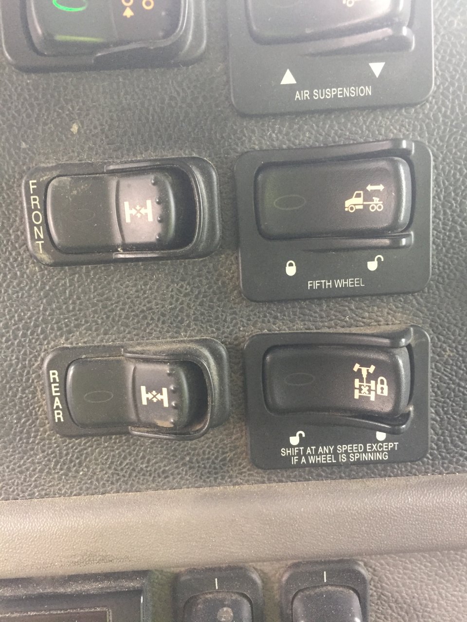

    This is a picture that shows a truck with both options.
    The middle switch, with the "X" between the axles is the power divider. The right switch, with the "X" on each axle differential, is the Differential Lock.
    When off road or in slick conditions of any kind I engage the power divider. Once I get in really bad traction conditions I engage the differential lock.
