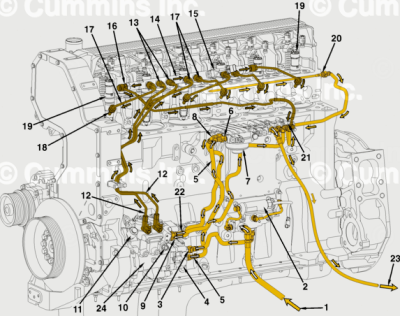

    What is the difference?
    I understand that the Fuel Pump Actuator tries to set rail pressure depending on output of the Fuel Rail Pressure Sensor. But what happens in a non-bypass Fuel Pump Pressure Regulator?
    What happens when the fuel is blocked from exiting the outlet ports on the Fuel Heads of the Hi-Pressure Pump? There doesn't seem to be a relief to tank? Maybe in the Fuel manifold?
    1. Fuel supply from tank
    2. Priming pump
    3. Fuel pump gear pump inlet
    4. Fuel pump gear pump
    5. Fuel pump gear pump outlet
    6. Pressure-side fuel filter inlet
    7. Pressure-side fuel filter location (4-micron)
    8. Pressure-side fuel filter outlet
    9. High-pressure fuel pump inlet
    10. Fuel pump pressure regulator
    11. Fuel pump actuator
    12. High-pressure fuel pump outlets
    13. High-pressure fuel rail supply
    14. Fuel rail
    15. Fuel pressure sensor
    16. High-pressure relief valve and drain
    17. High-pressure injector supply lines
    18. High-pressure fuel connector
    19. Fuel injector
    20. Fuel injector drain check valve
    21. Fuel drain manifold thermal recirculation valve
    22. Fuel pump drain
    23. Fuel return to tank
    24. High-pressure fuel pump.

    The commonrail pressure relief valve is on the end of the rail. It's not called out on your diagram. It is located at the #16 relief valve drain line.

    Yeah, the Fuel Pump Actuator routes fuel to the CR, and if Rail Pressure exceeds a certain value the Relief valve on the CR drains to the Fuel Manifold. But I was asking about the #11 Fuel Pump Actuator, and #10 Fuel Pump Pressure Regulator

    #12 is the outlets. If you are talking about #10 it controls the "medium" pressure" in the pump that feeds the HP pumping units. #11 controls amount of fuel entering the the high pressure pumping unit, this controls the effective stroke which controls amount and pressure of common rail.

    I think the OP is asking if the Nexgen pump was dead headed before the commonrail, where would the fuel pressure relief? inside the pump? ....with no return.

    Yeah. I meant #10. And I just found a video on a MB CR engine. The Fuel Pump Pressure Regulator routes fuel back to the inlet of the gear pump. Seems kind of strange because I am not sure how that relieves pressure from the gear pump. But... yeah. And by effective stroke you mean the barrel and plunger movement in the High Pressure Pump, right?

    Yes, the movement of the plunger. Here is description directly from Cummins of fuel flow which you may have already read.
    A priming pump is used for priming the gear pump at start-up. The priming pump runs for approximately 60 seconds after key ON and any time the ECM detects engine speed of 400 rpm or less. Once the engine is started, the gear pump is able to maintain prime without any assistance from the lift pump.
    Fuel flows through the priming pump to the gear pump. The fuel passes through a 4 micron, pressure-side filter. Filtered fuel is then fed to the high-pressure fuel pump through an 86-micron filter located in the pump body at the high-pressure pump inlet.
    The high-pressure fuel pump head actuator housing contains an air-bleed fitting and fuel pump actuator. The air-bleed orifice fitting in the fuel pump head actuator housing aids in purging air from the fuel supply. Because of the air-bleed orifice fitting, some fuel supplied by the gear pump will return to drain at all times.
    The fuel pump actuator is opened, or closed, by the ECM to maintain the appropriate fuel rail pressure. Fuel metered past the fuel pump actuator enters the high-pressure fuel pump inlet drilling, flows past the inlet check valve, and fills the pumping chambers. When the camshaft pushes the pumping plunger upward, fuel reaches rail pressure and causes the outlet check valve to lift. Fuel then enters the outlet drillings of the fuel pump and exits the high-pressure fuel lines to the fuel rail.
