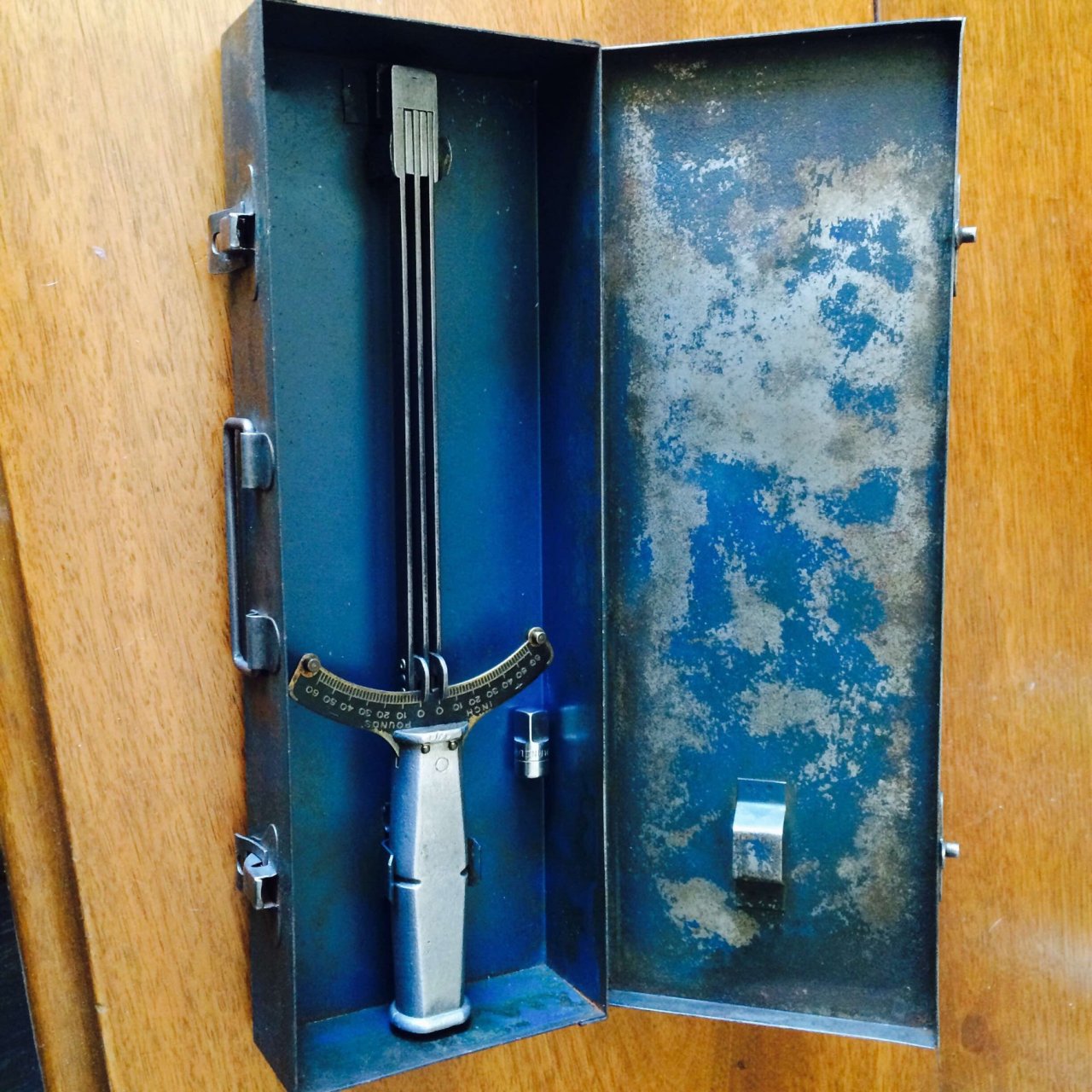

    8DC2D158-3C60-484C-A86C-ECC0693E404F.jpeg not a difficult job but must be done right
    Torque on bearing is quite
    specific. I got a inch pound beam wrench for passenger vehicle pinion bearings. Not sure what torque is on big truck but installation is the same

    Trucks use solid pinion bearing spacers so pinion nut torque is not as critical. You do need play with the spacer thicknesses until you get it right. You'd use the beam torque wrench or a spring scale to check the rotating torque of the pinion shaft to verify correct preload.
