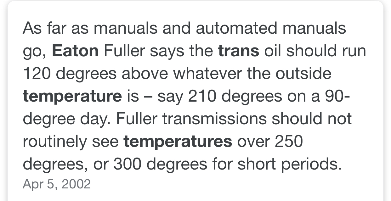

    My rtlo 18 cooler pumps trans fluid through it not antifreeze.
    For those wandering about trans temp, here is what Eaton says and mines always spot on
    Dino soar Thanks this.

    I understand and agree with you but Eaton requires them for all big trucks and especially warranty. Any truck with over 400hp
    beastr123 and swaan Thank this.
