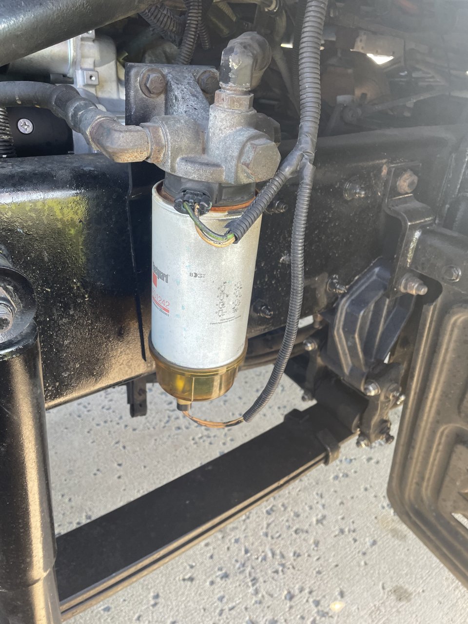

    Never changed this type filter before, would really appreciate a step by step on how to do it right. Thanks in advance

    Do you have the replacement filter ? You can look at it and easy enough to figure out. White part threads on/off. Can't quite see the bottom part in the pic. Should either thread on, clamp on or bolt on, that's if it's not already attached.

    My confusion mainly is with the bowl at the bottom. Do I just drain it, remove it and clean it? I’m assuming so, then I would just pre fill and screw it on?

    Should I fill it with atf or just some?

    My guess would be to pre-fill it about 2/3 to 3/4 full. And replace the o-ring gasket for the plastic bowl. I'm not sure there is one. But I'm pretty sure there is since fluid is going through. Also prime the filter as well. It's probably gonna take about 3/4 of a gallon.

    On these newer model trucks, I wouldn't put ATF in the fuel filter. Just because of the way ATF is now designed with all of the additives, and the friction modifiers, and such. Now, the older trucks from like the pre-90's models, yeah that was a lot more common. Especially the 2 cycles from way back in the day. They were a pain in the ### to start up again if you ran out of fuel. The ATF in with the fuel filters made it a little easier to start up. In cold weather, these older engines were a pain in the ### to start up. Add in some ATF in the fuel tanks, and the lubrication and a little extra BTU's from the ATF helped start right up. I guess it acted sort of like 2-cycle engine oil. But now we've got these motors that run on high-tech computers, emissions systems, injectors and injection pumps, and everything else. So I would just stick to using clean, filtered diesel for priming fuel filters. Better to be safe than sorry. Especially with how much these emissions systems repairs and maintenance costs are.
