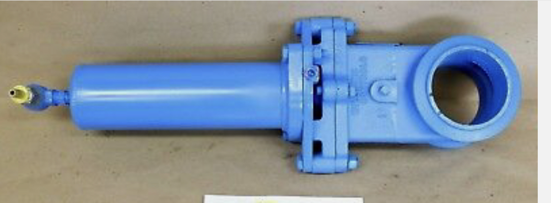

  11. SmallPackage
    5,518
    17,573
    Dec 20, 2019
    Marion Texas
    The only other option was this contraption
    the William’s Controls guillotine style exhaust brake. Aka. “Blue Ox”
