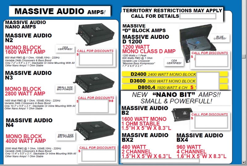

    Most car stereo amps from off brands, and many that are intended to be sold to booming-bass lovers and rap-music lovers have their power rated at clipping, max. output. This is because that is how those idiots run their stuff. Divide by two and the RMS power is somewhere close. The attached is a sanitized page from a current wholesale catalog, which informs dealers as to peak and RMS ratings, so that the salesperson knows what to say. -so the practice is common, nothing wrong with it as long as the customer is not lied to.
