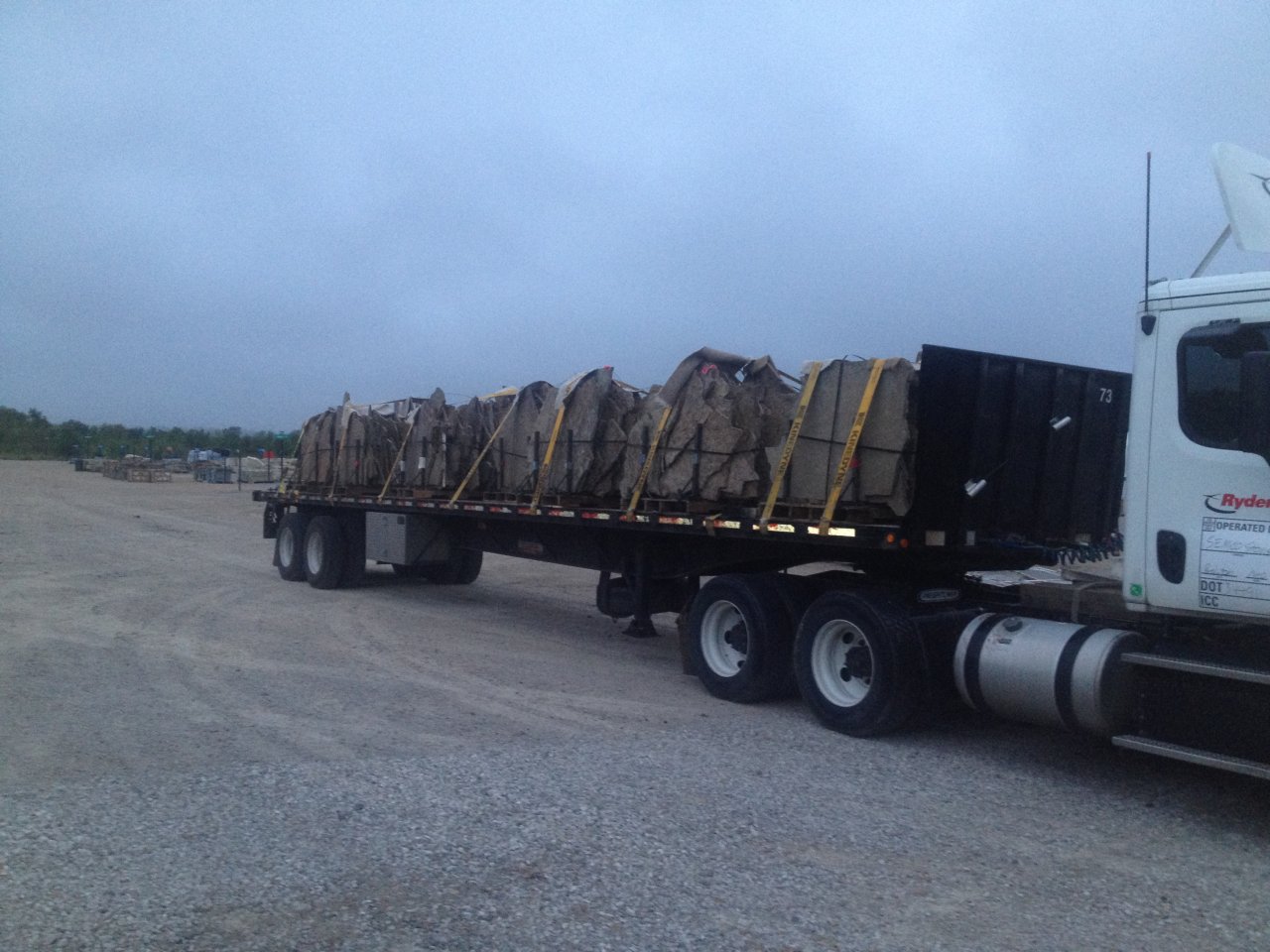

    You’re 100 percent right. Two straps are required to prevent forward movement. That’s only in the front row or if you have a gap in the load.
    Two perfectly legal loads. Straps outside the rail and a single on the back. Oh the horror...

    I'd like to get my hands on a load or two of that stone! Do you run that a lot?

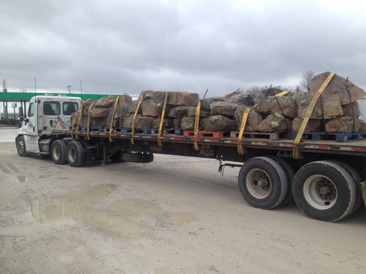

    No edge protectors (second pic)? If you read the handbook it says only chains are to be used on boulders.

    I was working for the largest stone distributor in the Midwest at the time. That’s all we hauled.

    Edge protectors were used where needed. Rounded sandstone doesn’t hurt the straps. Can you link me to this regulation that says you can only use chains on boulders?
    Surly you’re not referring to 393.136
    §393.136 What are the rules for securing large boulders?
    (a) Applicability. (1) The rules in this section are applicable to the transportation of any large piece of natural, irregularly shaped rock weighing in excess of 5,000 kg (11,000 lb.) or with a volume in excess of 2 cubic-meters on an open vehicle, or in a vehicle whose sides are not designed and rated to contain such cargo.
    Those boulders are a bit under 11k pounds a piece. Closed to 800 pound a piece.

    Yeah I guess since they’re light enough that’s legal. No way I’d tighten straps over those though without some carpet or something. You must not pay for the equipment.

    I hauled those loads all the time as long as the boulder edge wasn’t broken they won’t cut a strap.

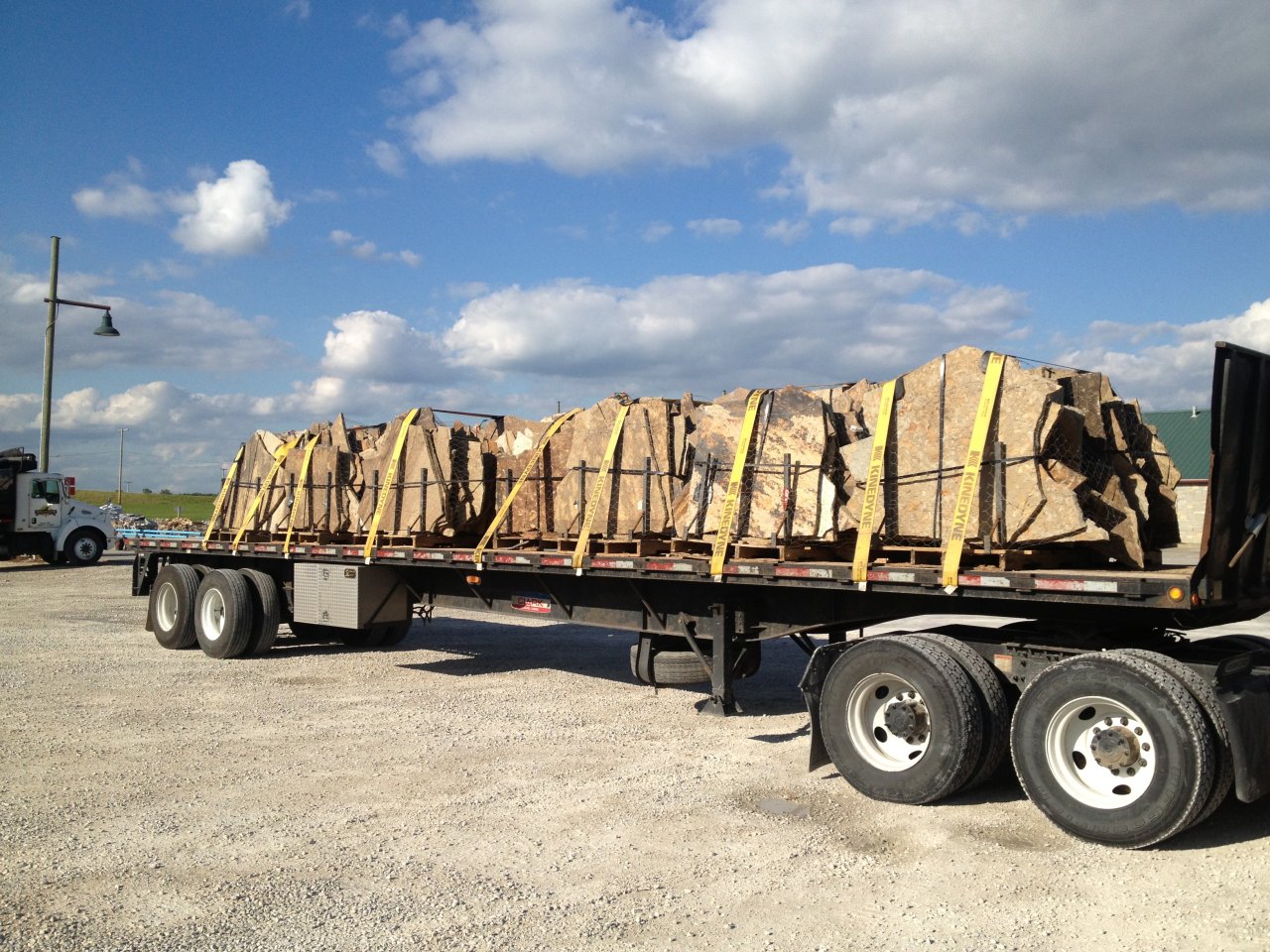

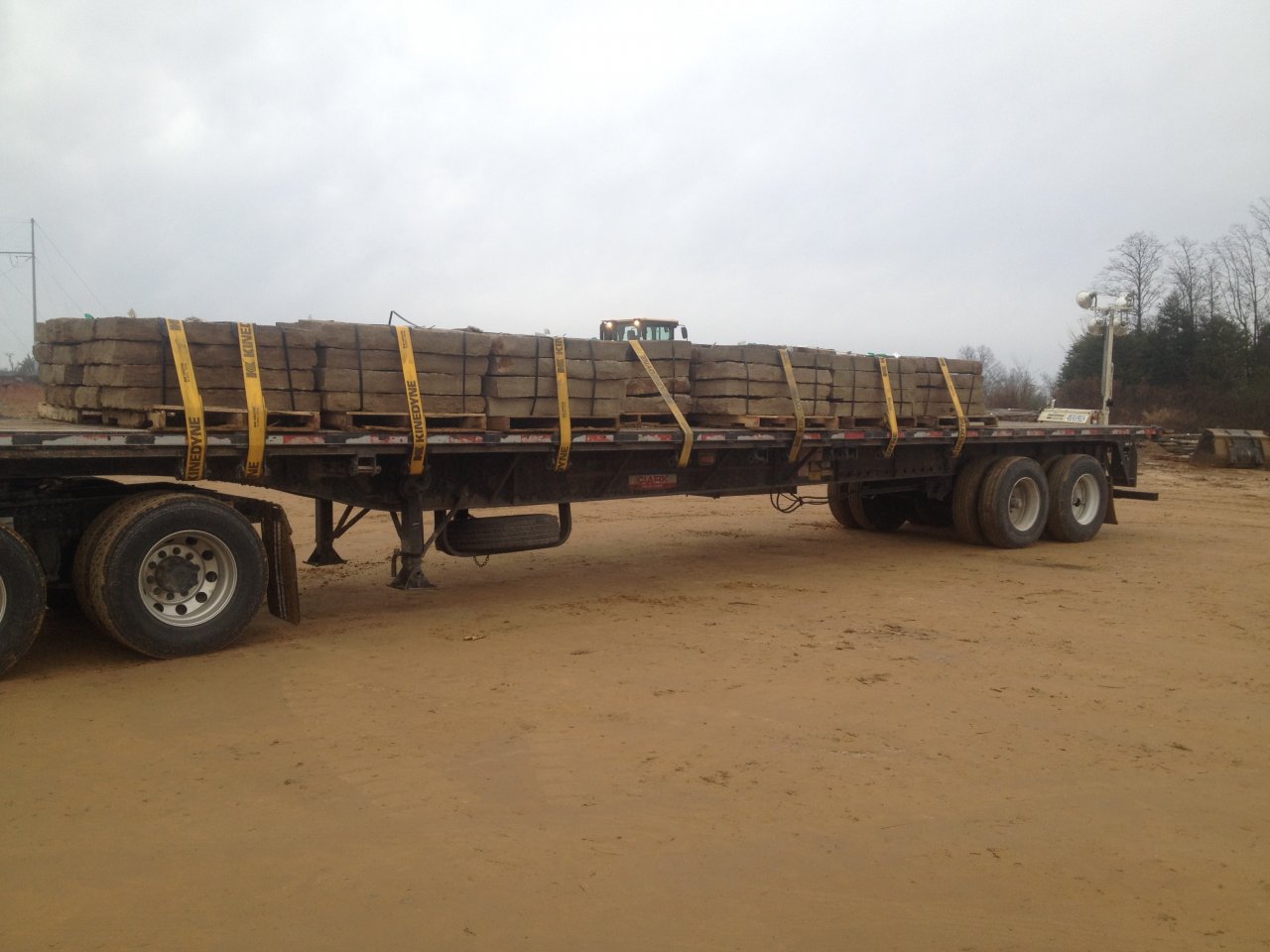

    If your worried about those load you would hate these. Even with carpet they would cut the straps at times. I tried to get them to get me chains for these flagstone loads but they refused.
    I actually had carpet strips 1’x4’ I used on these loads but #### still happened.
