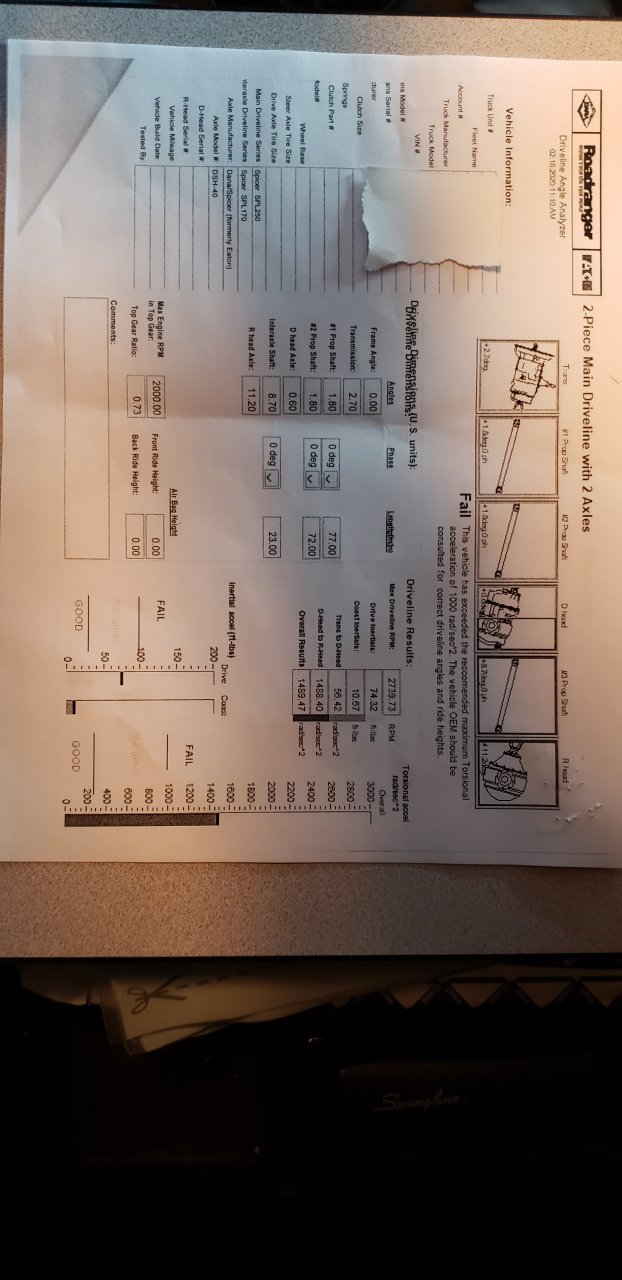

    I just had mine done at Peterbilt where I bought my truck as it was a warranty issue. Had lots of vibration. Took them 2 days. According to them it is a step by step process. Had to have clutch adjustment as that is a part of the checking process. Here is the sheet that shows "Fail" when they checked it. 20200301_155639.jpg
    Drive line need 1.5 shim

    And how old, how many miles to have a fail and it still be under warranty?
    Rideandrepair and JonJon78 Thank this.

    How old is the truck? 2020 with 63k miles... I starting noticing vibration around 55k miles or so. I'll have to check my warranty and see how many miles the driveline is covered up to.
    I've driven the truck about 5k miles since it was repaired and so far all is good.
