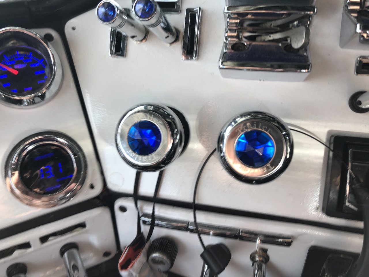

    Jake switches are the ones above the tractor/trailer knobs. If they’re not there, remove top panel and look down for the wires. Should be 2 groups of wires with 6 prong connector plugs. If you find em, you can run a jumper wire to see if they work.
