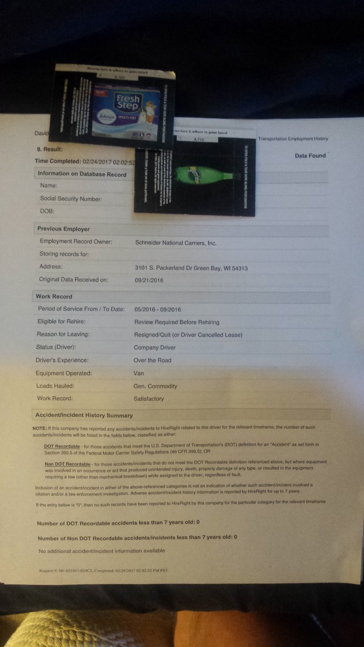

    I have a theory on this matter. This is a fairly new copy of my DAC. When I drove for Sccccchhhhhhnnnnneiser last summer locally on e log, I violated my 14 twice, and forgot to log out for my break once ( at which time the QC started freaking out so bad, I almost tossed it out of the truck for fear of detonation ).
    They only show Tickets or Accidents / incidents. I think if you don't receive a citation it never happened. Cause the people were HUGE ERECTIONS, and if there were a way to hump the driver with a pencil or pen, they would surely do it.
    I pulled a reefer locally, but they show OTR / van, my theory for that is probably do to the pay scale, or just one size fits all reporting.
