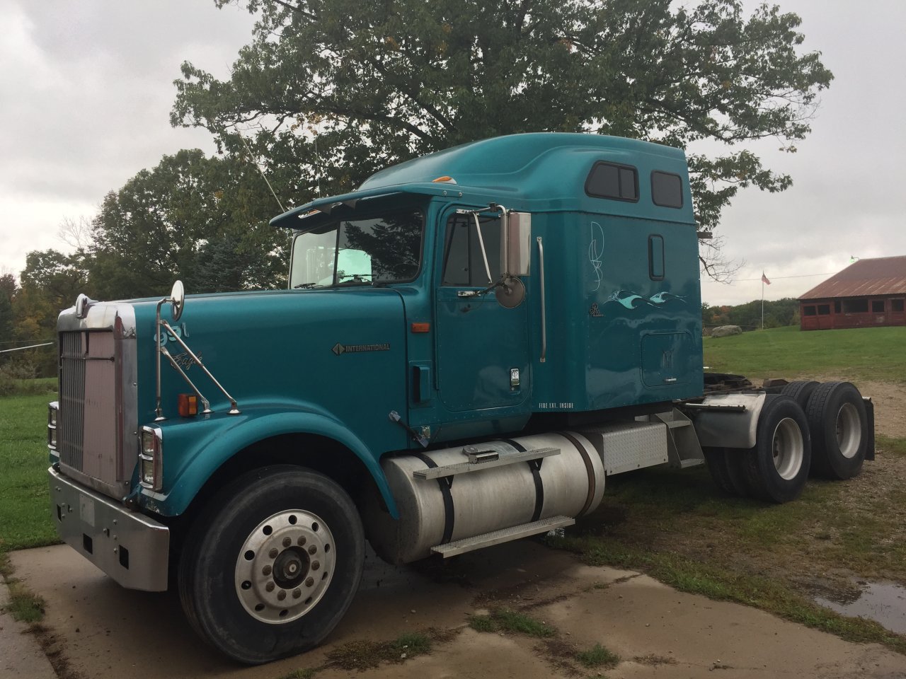

    B4461CD8-8AB1-40C0-876A-32FA2EA8B304.jpeg I was making my living in the commercial parasailing business for many years in saltwater until I sold out few years back.
    Multiple boats and trailers to maintain along with problematic hydraulic systems for the towline winches.
    Been wrenching all my life,54 now. Hate doing it when it is a time crunch deal on a pain in the neck part to get at.
    That was everyday wrenching on the parasail boats, and the saltwater corrosion just added to the misery.
    So here I am now, just started driving 11 months ago hauling milk in tankers driving a 3 year old Western Star 3900sb glider.
    Love the job. Love my company I work for. Love my truck and our trailers.
    But growing up with an entrepreneurial father keeps me from ever being satisfied working for someone else.
    So about 6 months ago I fell upon what I felt was a good truck after looking at many along my travels I Was not looking to buy immediately but knew I would kick myself if I didn’t buy it
    Clean one owner small trucking company maintained 97 International. N-14 13 speed with a million 175 on it.
    Heads just done and last oil analysis from owner came back exceptional condition for the age and mileage.
    Drove it 250 miles home.
    What I will do to it before it goes on the road.
    All new brake drums,shoes,cans,hoses airlines.
    4 new airbags and lines
    Front end feels tight but it will be thoroughly inspected along with wheel bearings and seals.
    10 new tires and balance rings with Alinement
    Dropping the tranny and new clutch, flywheel resurface, clutch brake new input shaft and bearing.
    New tranny and motor mounts.
    Rebuild tower and open cover and flush and inspect tranny.
    Replace the problematic injector harness under the cover.
    Pull the axles and inspect the bearings and reassemble with new axle and pinion seals.
    New radiator and heater hoses. New belts.
    New 5th wheel.
    New seats and do some remodeling on the sleeper.
    Paid 15 for the truck and probably going to have another 15 and 100 hours labor into it with out doing the sleeper remodeling.
    I will have another 5 on the table for other possibilities ie. batteries, radiator, blown rear end
    But I am confident I will have a good reliable truck after that.
    If the motor acts up it will be pulled and done with no expense spared to make it right.
    I just can’t stand looking at stuff and knowing it could fail tomorrow.
    Not a gambler. Never will be. I flew 10s of thousands of people in the past and the worst injury I had was a stubbed toe once.
    My competition 4 miles down the road killed a mother and daughter. Improper maintained and replacement of equipment was cause.
