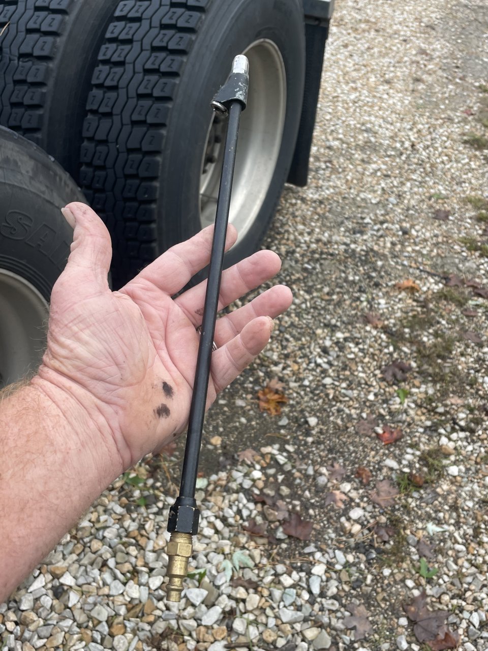

    You do know that you can put any end on a hose you want.
    I have one that allows me to switch from one to the other in about a second flat.

    Self locking, think it was $16 at Rural King. Works slick as a hounds tooth….
