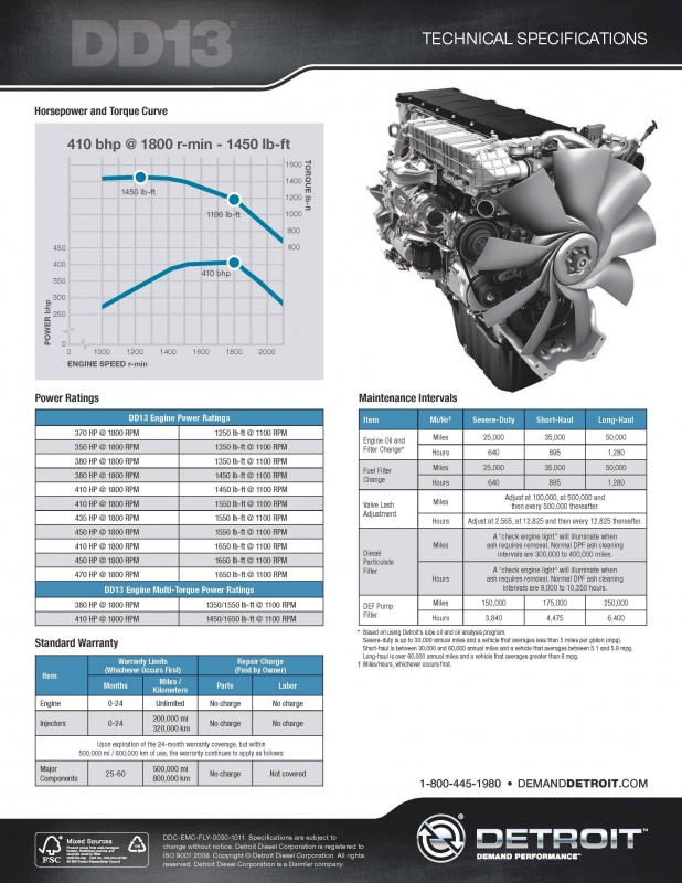

    You can see from this rating file what our curve is, our trucks at 70mph are running right at 1500rpm, as you can see, we are FAR from the bottom of this engines sweet spot.
    I was always told that you want your engine to be running at or just above peak tq, rpm, so that when you encounter a pull you are pulling down "into your tq curve, which as you can see, is exactly what we are doing.
    This tq curve IS FLAT all the way from 1400 to 1000 rpm.
