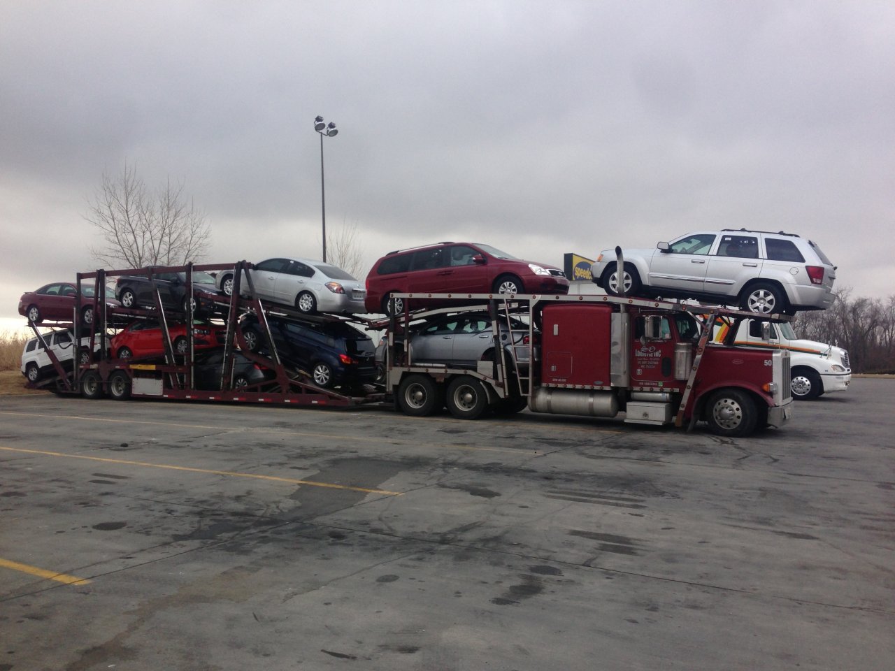

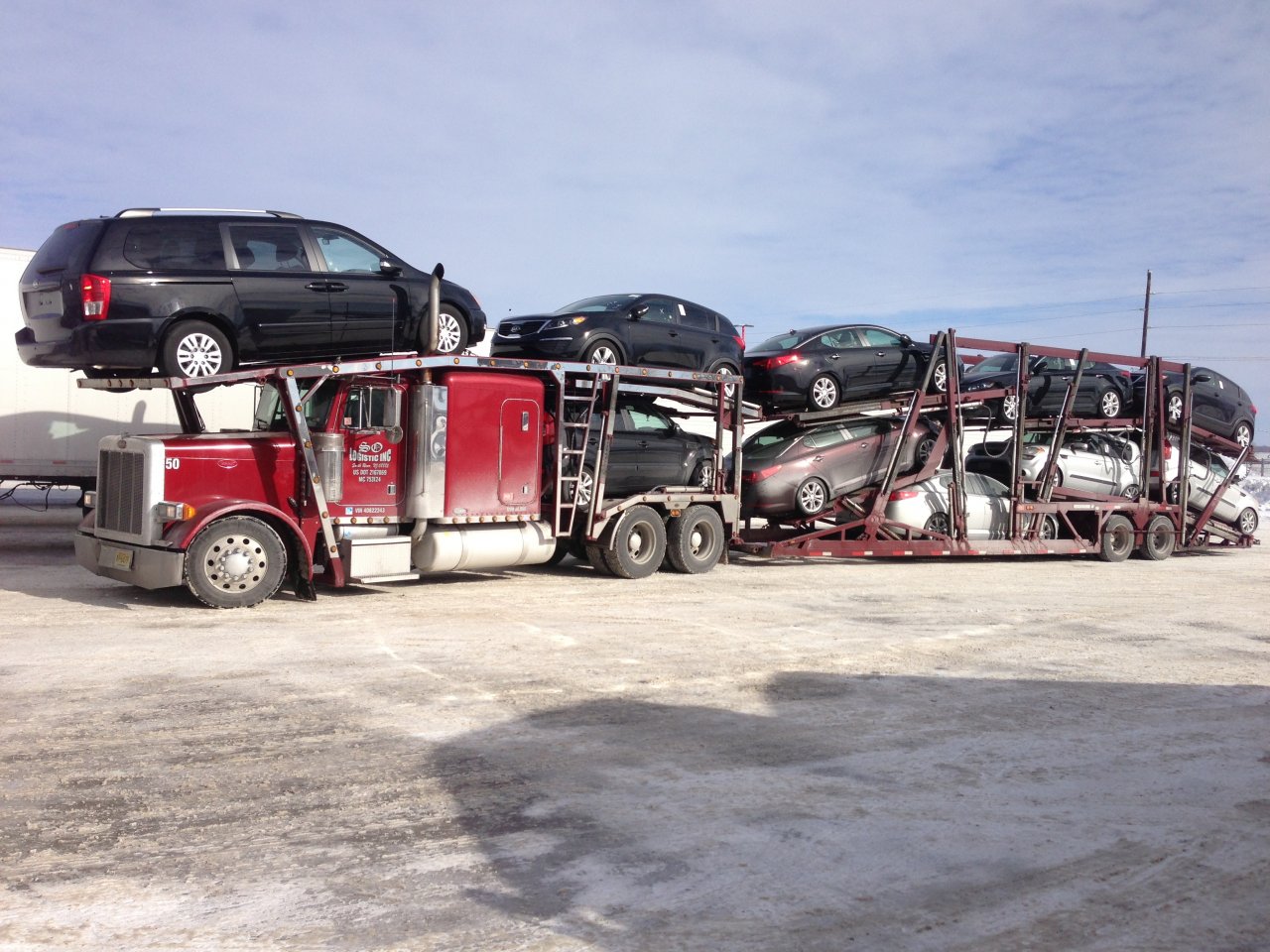

Does anyone here run a new 2016 Boydstun car carrier???

    How much does your truck weigh empty? Looking at one with identical set up. Having a lot of issues with the Cummins? Awesome looking truck BTW.

  2. AlexCarHauler
    AlexCarHauler Light Load Member
    Joined:
    Apr 8, 2013
    Messages:
    175
    Thanks Received:
    44
    Location:
    Brooklyn NY
    A lil more then was thinking, 44300 on full tanks(120&90/30)and DEF. when I'm ordered my truck, was weighted same truck on half tanks and its was 43300. 2007 about thousand pounds less. The Pete a lil lighter, but have smaller tanks.No much issue on 175k, just troves some fake kodes about bad DEF fluid or maybe fluid it's really bad, gets from pump no TA/Petro.its really bothering me after non emission engines.
