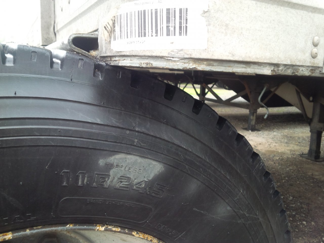

    Please, please, show me a picture of a gap.

    My truck is basically married to my trailer so it's very rare that I even have to drop it.. I would say maybe roughly 12-20 (if that) times a year I drop my trailer..
    All our trailers, trucks and 5th wheels are the same heights and sizes.. On a empty trailer I will drop it with the legs about 1/2 or so from the ground, dump the backs and drive out.. Then when I back under it or someone else the legs are off the ground and it's that much easier to dolly legs up.. If the trailer is loaded then I drop the landing gear to the ground.. Very hard to back under the trailer if it was dropped with legs 1/2 - 1" high from the ground. Trying to back under a trailer with 80,000lbs in the box is tricky so much resistance..

    Yeah, go spend some time hauling cans around, they're either dropped 8" low or 14" high. I've had some that were so low, my drives wouldn't fit and the hostlers played heck trying to get under them. And I've had some that were so high, I spent 20 minutes cranking it down (those 50K marble loads are so much fun to crank down). Conagra in Commerce City, Co., the hostlers are notorious for dropping stuff high. They always try to blame the dropping driver. Caught them in a lie several times, dropped one one day, stopped an inch from the ground, dumped my airbags and pulled away. Came back three days later to pick up the load, with bags inflated it was 6" high. Hunted down the hostler, when he backed under and raised it so I could crank the legs, he said "yeah, the driver that dropped it must have had a really high 5th wheel, we never touch them". Really, huh, that's odd, I'm the one that dropped it three days ago, see, here's my dispatch sheet showing it, and this is the only truck I drive. He shut up real quick.

    Inch from the ground and let the bags drop it. Heck of a lot easier to drive under it than crank a loaded trailer. all of our trucks are the same. Work smarter not harder

    Trailer with air ride aren't always the same, some drop when you release the air and set the brakes and some not so much, the ones that drop tend to be difficult to pull the pin on as well.
    We have a sloping yard and the gravel tends to work away from from the concrete support pad, those trailers are almost always sitting high and that is where they usually park the loaded ones.
    Airing up the trailer, which releases the brakes , tends to unpinch the landing gear and makes cranking either way go easier, but if the trailer is one that drops its air bags quickly, releasing the air again will raise the front of the trailer a bit more with less cranking. Airing those up after hooking will also take some more weight off of the landing gear with less hard cranking.

    I've had this happen too many times. People are so lazy. Here's what I do if a trailer is dropped high. I just back half way under it. Then hook up the air and pressurize the trailer suspension. This lifts the back and lowers the front end. Usually that's enough to take the weight off of the landing gear so you can easily crank the landing gear. Easy peasy.
