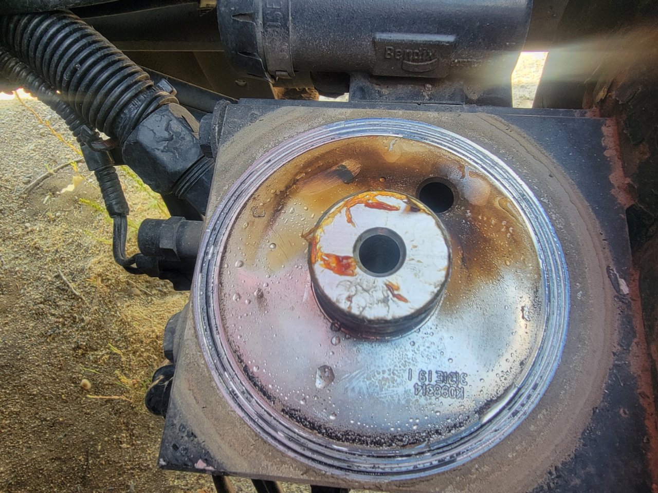

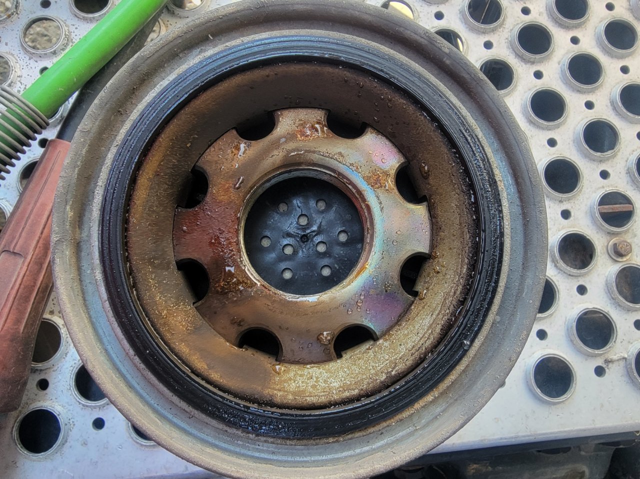

    Here is what mine looked like. I put a very small amount of grease on the threads since the old one appeared to have grease applied. It was like $25 from my Kenworth dealer. Old one came off easy with the filter wrench I bought.
