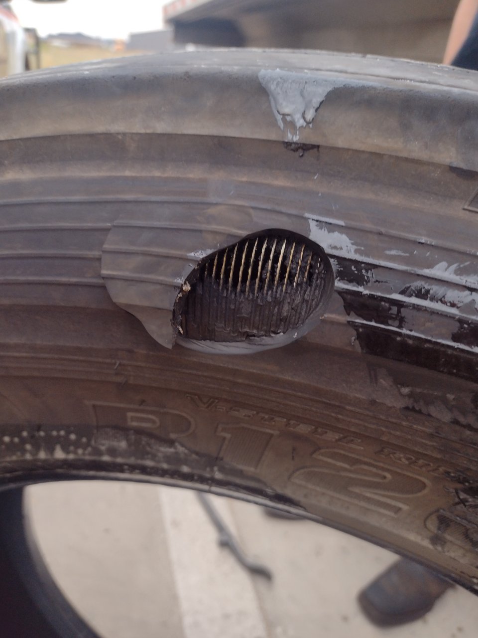

    I actually had a can of starting fluid in the truck but I am too big of a puss to do that. I tried one strap right in the middle of the tire to start with and that wasn't enough so I used two and put them on the edges. That seemed to work well enough and is probably a bit safer. I wouldn't recommend anyone try to reseat a bead with starter fluid at the fuel island lol.
    Here's a picture of the sidewall on the tire

    Mar 4, 2015
