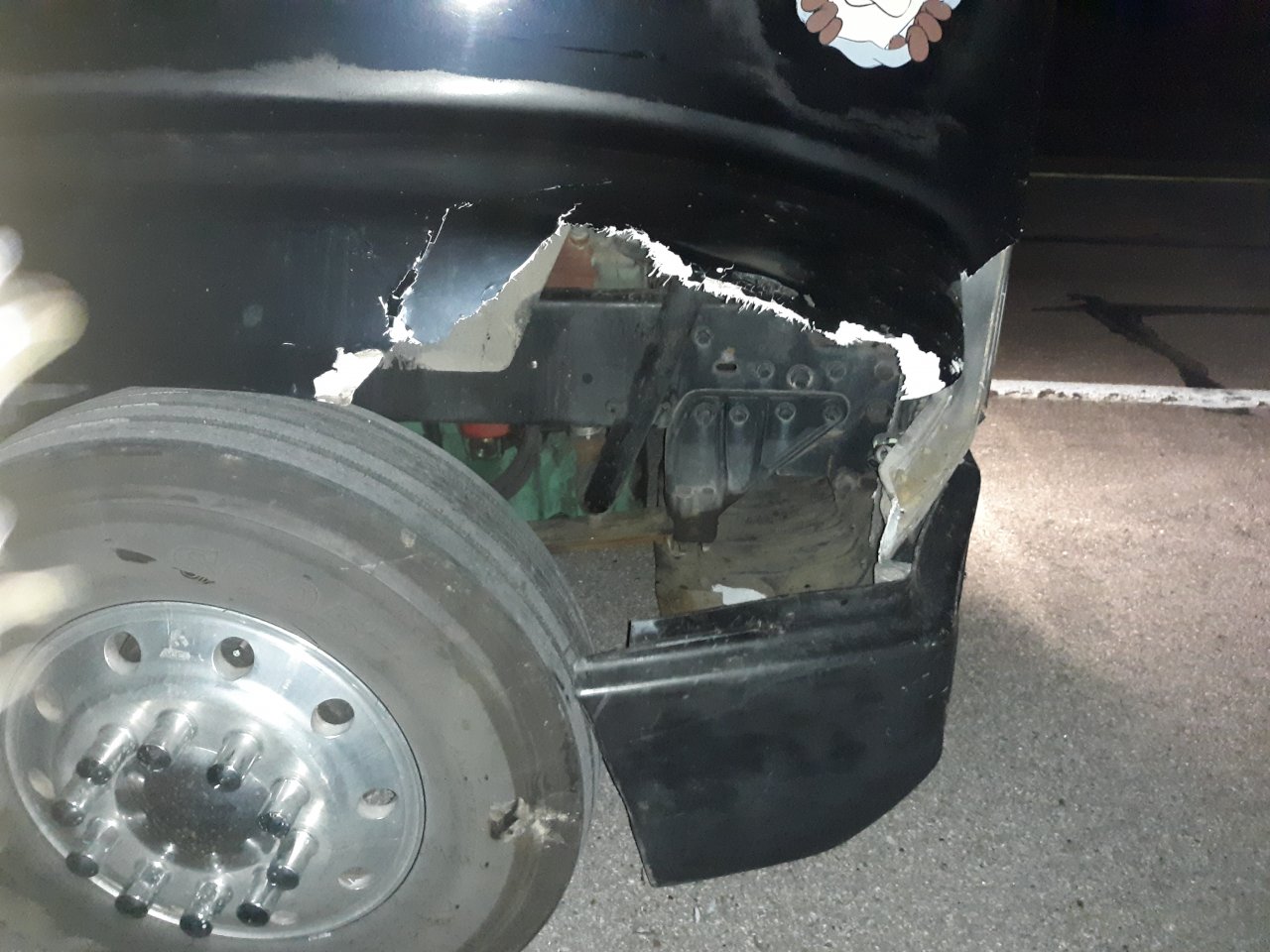

    Well I had a run in with bambi's pop on the 4th of Nov. Brought her to the home 20 on the 11th, & been piddling around since then. Adjuster took forever, I procrastinated too, it's a whole stupid saga. Just called it a year, so I'm of no value for the last 7 weeks of what freight in my range has been up to..
    With that, usually I leave FL & stay gone a couple, few weeks. I'm more of a 300-400 mile, $1k a day kinda guy. That's my arena of making money. Seems when I grab those 1,000-2500mile loads, the rate per mile falls.. I have seen the longer runs, & if high miles, lower rates is what you're after, they are out there. Just be sure to run all the way to the 5 corridor if you go west of i35. Slim pickens in between..

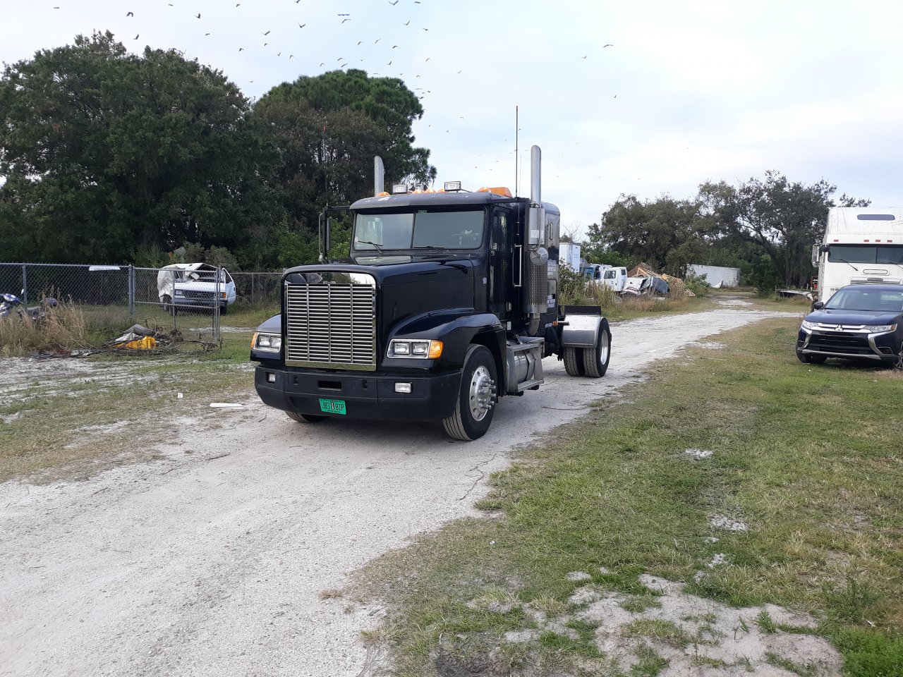

    With the copilot I'm hoping we can beat down some doors on our 2 hr window to pick up some value adders on the longer hauls. Also have a bit of support from the home base. 5500 miles per week is the sweet spot per my calculations on cpm.
    If you don't mind me asking what is your average cpm in the class 8 at current fuel? Assuming the truck were paid for.
    Too bad to hear about the critter. I love the comfort of the old flds and such. Direct 10, highway gear and a 60 series. They actually do pretty good mileage. What is the spec on your rig?

  8. singlescrewshaker
    4,852
    42,402
    Dec 31, 2017
    Little Havana, FL
    It's actually a 32k lb class 7 fld120.
    1993 model
    Factory single screw.
    DDEC II 11.1 350hp Series 60
    fuller rtx 9sp .73 od
    12k steer
    23k rockwell RS23161 on 20k lb airliner suspension
    4.10 gear
    11r22.5
    Surprisingly even cranking along at 1600-1650rpm all day, as long as the boost stays low she does pretty good..
    IFTA generally in the mid 8's mpg. Quarter high of 9.12mpg, quater low of 6.95mpg.
    With fuel @ $2.50 gal & say ~8mpg average ~31cent per mile for fuel..
    Operating cost for 7,000 miles per month is 89 cent pm. That includes 4 nights in a motel. That doesn't include paying myself though.. I've met a hotshot once who claimed his OC was in the 60 something cent range, but I'm sure he runs more miles than I..
    I'm not really sure about that FLB. I asked about it too, but got a vague answer. Think it's a '95, Series 60, wants $5k for it. "Ran when we parked it.." lol Shoot, if it really runs its worth $5k just for the engine..
