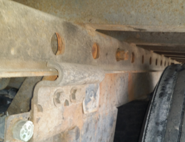

    A little rust around the tandems, but the metal is still very solid:
