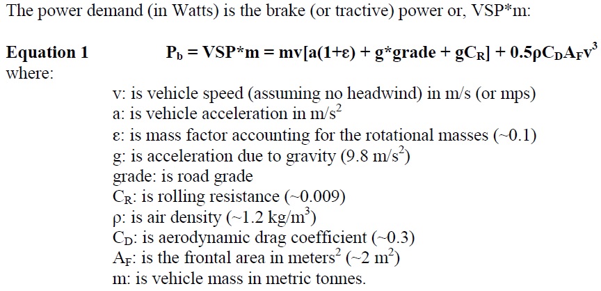

    The physics of MPG (part 1)
    I've been meaning to post this for a while, but it is one of those seemingly simple topics that has lots of special cases. But with people learning more and more about it from here, or KR, or the facebook 9mpg club, I think its time to go into a little more depth.

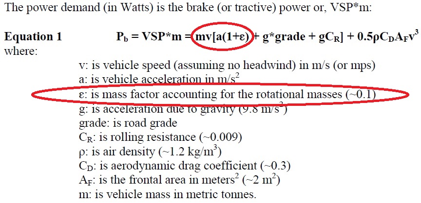

    This is the formula for power demand (ignore the constants, they are for cars):
    Don't let the length of the equation throw you, it simplifies considerably if you stipulate steady speed (no acceleration) and flat ground:
    Power (flat ground, no acceleration) = m*v*g*Cr + 0.5*p*Cd*Af*v^3
    That's a little better, right? It can break down even more:
    Power (flat ground, no acceleration) = rolling power + aerodynamic power
    where rolling power = m*v*g*Cr
    and aerodynamic power = 0.5*p*Cd*Af*v^3

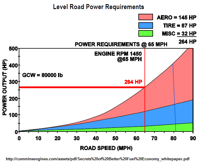

    How accurate is that formula?

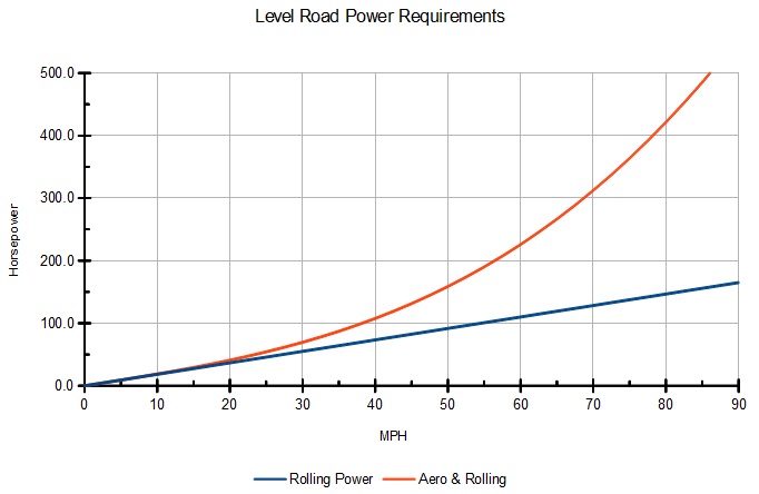

    Most of you have probably seen this graph from the Cummins MPG whitepaper:
    This is the EPA formula using the constants I provided:
    The only real difference between the two graphs is that Cummins separated tires from other rolling resistances (tires make up ~75% of rolling resistance).

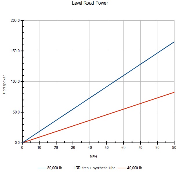

    Factors that affect rolling resistance:
    m * v * g * Cr
    This is a linear equation, which means if you halve any of the terms, the result is cut in half. For instance, if you were to go from 80,000 lb to 40,000 lb, the rolling resistance power demand is halved:

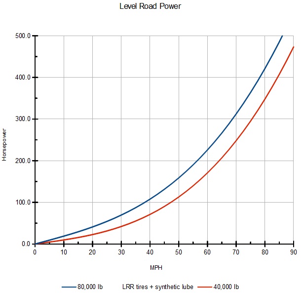

    with aerodynamic drag:

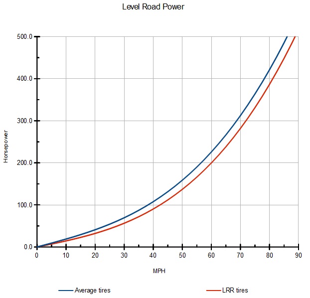

    Tire rolling resistance of a typical truck:
    Steers: 110
    Drives: 140
    Trailer: 100
    That averages 118.5 -- (12,000 * 110 + 34,000 * 140 + 34,000 * 100) / 80000
    Using the lowest rolling resistance tires currently on the market brings that down to:
    Steers: 78
    Drives: 89
    Trailer: 75
    average: 81
    Which brings the overall coefficient of rolling resistance from 0.0086 to 0.00656:

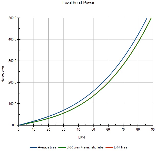

    But what about bearings?
    Remember that 75% of rolling resistance is tires, so of that initial 0.0086 coefficient of rolling resistance, 0.00215 of it is from bearings. Changing to synthetic fluids, for example, increases bearing efficiency by ~5% at 100F -- changing its contribution to the coefficient of rolling resistance from .00215 to .00204.
    Unfortunately, bearings are extremely efficient so that 5% improvement is imperceptible when looking at the big picture:
    Keep this in mind when listening to a salesman promise large mpg improvements if you switch to their magic bearings or lube.
