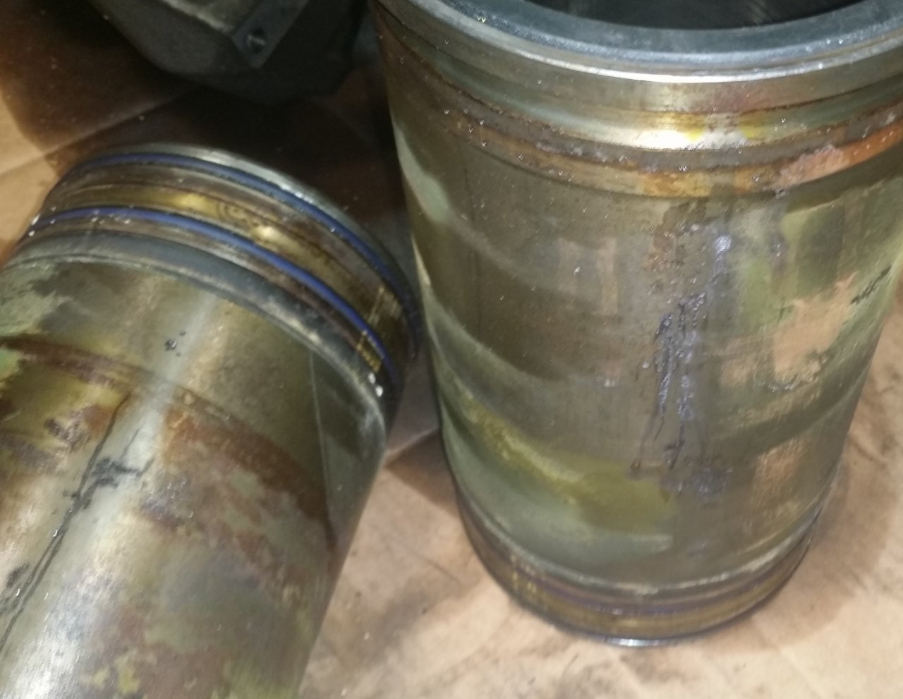

    To be fair, it has never broken down -- something I can't say for the new emission trucks I drove as a company driver. And I was prepared to face an overhaul right off the bat so getting 75,000 relatively trouble-free miles (aside from unplanned A/C & headlight repairs) first was a pretty nice bonus. Every other repair (brakes, seals, etc) was planned and/or done while on hometime.
    And I could have just replaced the 1 injector along with the injector harness and perhaps gone another year before needing an inframe, but I prefer to do things right the first time. In this case, that involved removing the head to replace the injector cups at which point the labor was high enough it didn't make a whole lot of sense not to inframe now considering the scouring in the 1 cylinder.

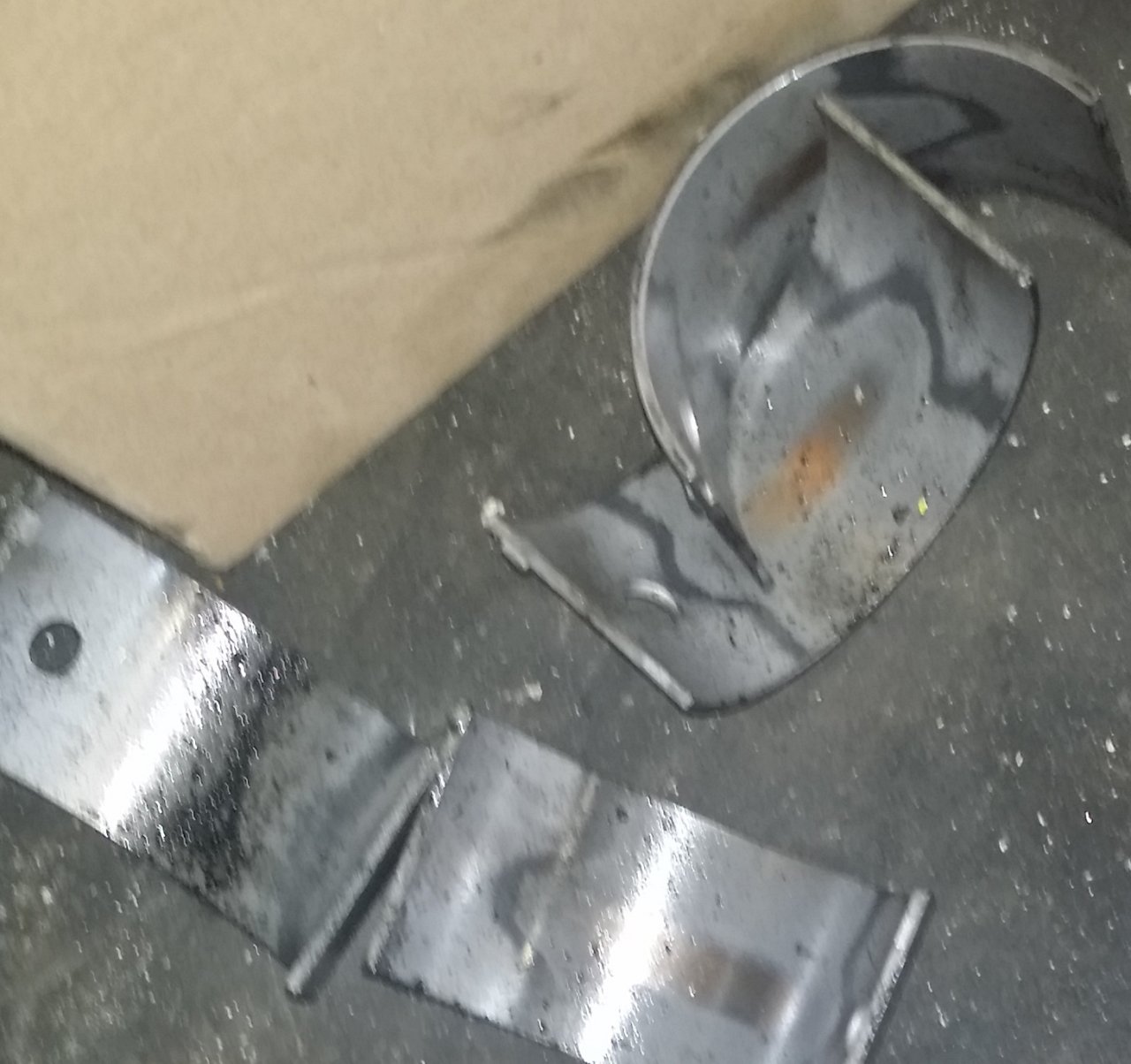

    In this case, it was a blessing in disguise to do it now. The liners had a little bit of pitting on the backside:
    But more concerning was one of the bearings was not long for this world (and the others weren't too far behind it):
    (sorry for the crappy picture)
