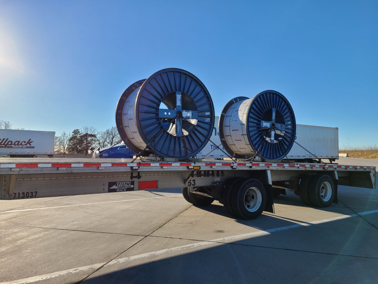

    I did 3 years with FFE! Their plasma is a team deal. Eventually decided I wanted my own truck.
    Despite my difficulties, flatbed is fun so far. I drove all the way to the consignee and there's a big, wide open lot for me to park in. No parking woes.
    I'll probably do this for a good while if I can keep out of trouble. There's more to worry about. More stuff DOT can jump on you for.
    That load is only like 35k or something like that. But I also forgot to ask how to scale those spread axles before I left. Lol
