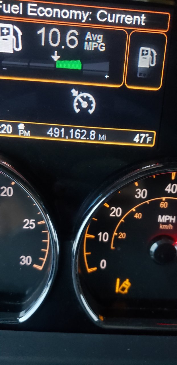

I believe it is fixed. Drove about 30 miles bobtfil and another with trailer . No problems.
Got lucky and that shorted wire for the fuel pressure sensor has stayed connected good. Won't last long though .
Getting up to 11.3 mpg bobtail and about 8.8 to 10 with empty trailer .
This truck does great on fuel when it is working right.Attached Files:
