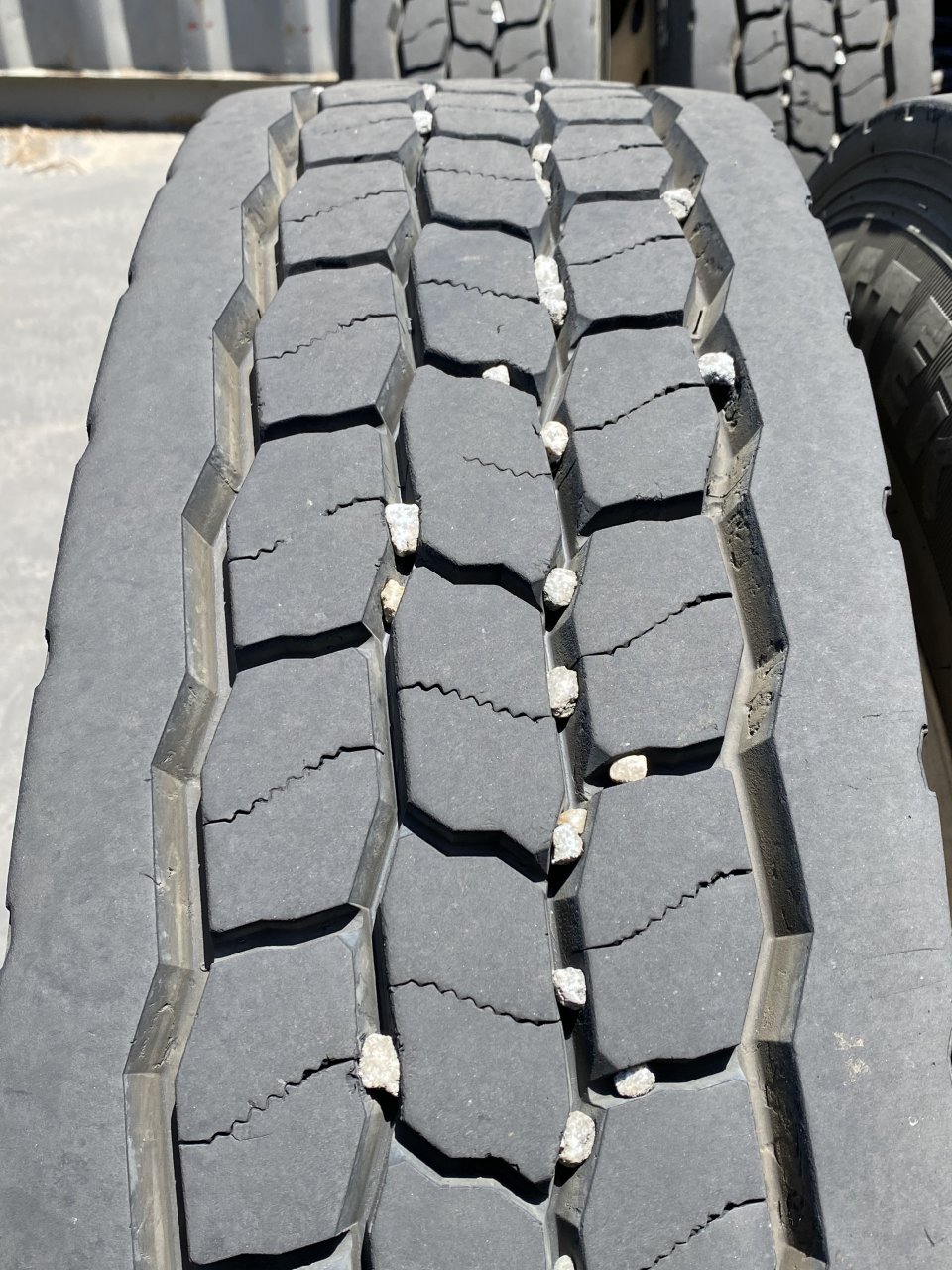

    1A52B87B-AA7F-4181-9DD0-7B058429FA6C.jpeg Roadmasters for your application. I had them on my 94 Pete and had goodluck with them. Only downfall/complaint is they collect a lot of rocks/gravel on the tread. I kept yanking them out. Over all a decent reasonable tire.

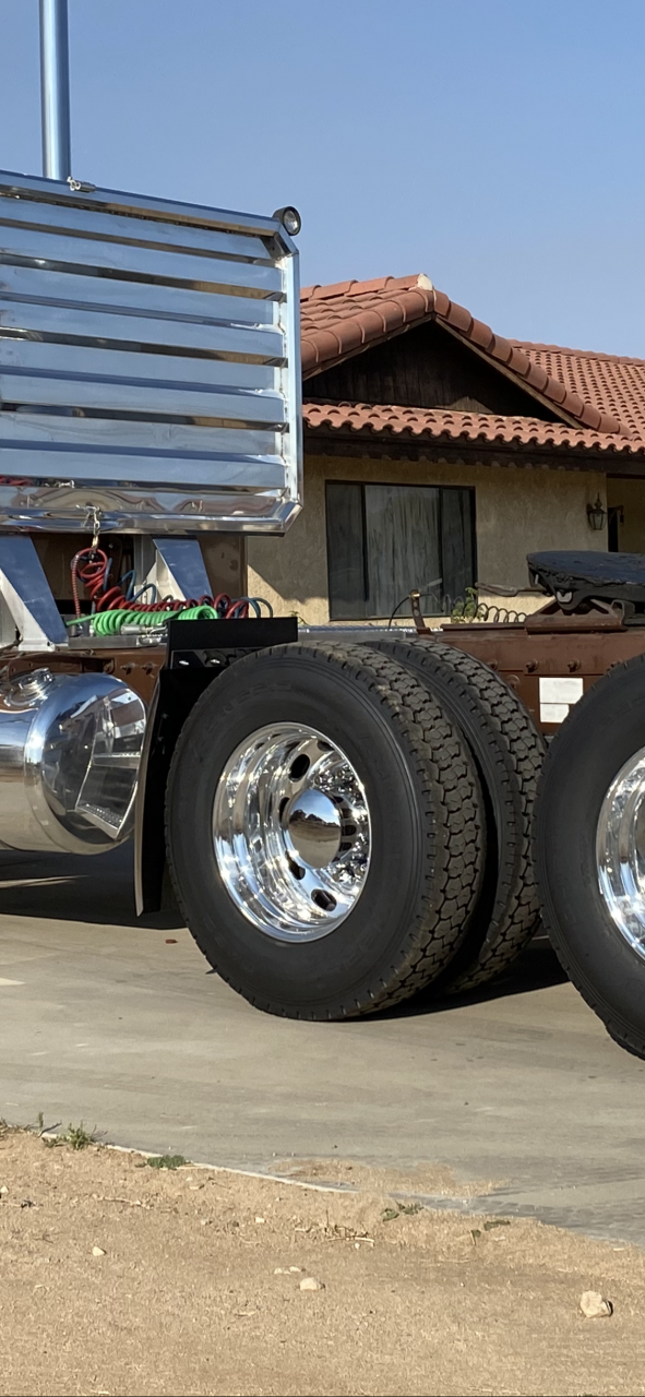

    On my 2014 Pete, I’m running Ameri-Steel. They resist rock/gravel. Best tire I’ve ever ran so far.
