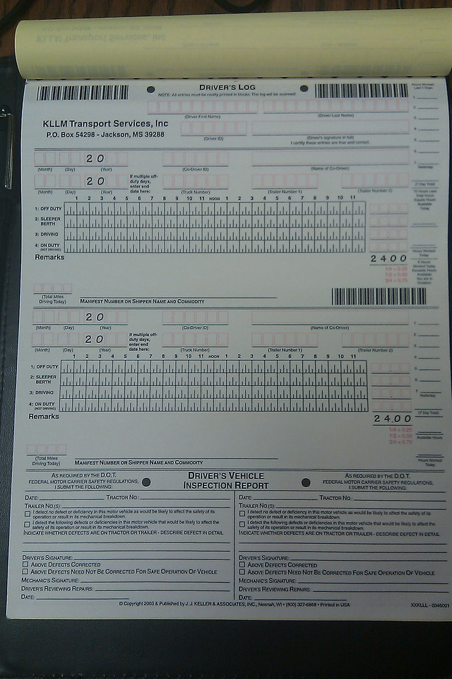

  7. Pmracing
    Pmracing Road Train Member
    Joined:
    Jan 28, 2011
    Messages:
    6,354
    Thanks Received:
    3,178
    Location:
    Arlington Heights, IL
    our logs have a schedule on the right side to keep track of your day totals. It is not part of the official log area. you can make all the notes you want.
    It shows your past seven days, a line under that for their total, the next line is for your available hours, and the next is for hours worked today.
    It is very helpful for beginners, in a week or so it will just be tedious repetition...
    Sorry for the large photo. Just tried to make it big enough to see...
