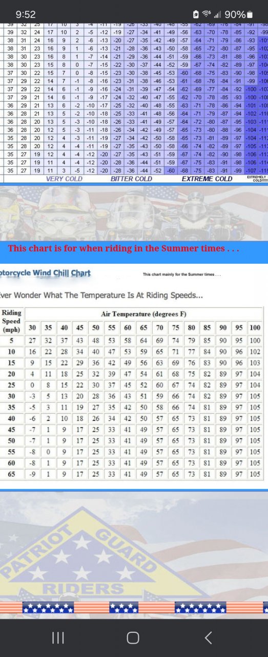

    Wind chill has NOTHING to do with making it colder. Any object will only drop to ambient temperature, not colder because the winds blowing.
    kylefitzy, MACK E-6, Oxbow and 2 others Thank this.

    That was a battle I wasn't sure was worth fighting in here. I've never quite understood why people have such a hard time grasping the difference between heat & temperature, and how wind chill measures the loss rate of the former and has no effect on the latter.

    Imagine riding a motorcycle in 40* and your fingers getting numb with gloves on. Vs someone just standing around.
    We wear coats up to 60* or whatever while everyone else not riding is in shorts.

    Only living things feel the affect of wind chill, everything else simply drops to the ambient air temp faster than normal. If it’s 20 degrees out and the wind chill is zero, to me it will feel like zero. To my warm truck that I just parked it means everything will drop to 20 degrees faster.

    Wind chill is a highly overrated concept.
    If it is zero degrees ambient then that is as cold as anything will get no matter how hard the wind is blowing.
    It measures how fast a body (exposed skin) will reach ambient temperature.
