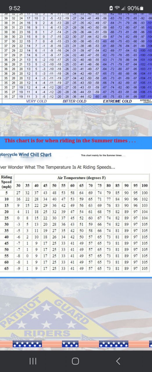

    Exactly right. And the misconceptions about windchill happen because people incorporate the emotional, hyper-dramatic language of the fools on TV weather reports, but don't think about it before accepting it. It's elevating the emotional above the factual. A nice dinner isn't just nice, it's awesome, magnificent, best in history, it changed my life.
    Why don't the roads freeze over at 40 deg F with a 30 mph wind? The windchill is 28 F. The idea roads can freeze above 32 F is thinking like 4-wheelers drive, an unnoticed mistake waiting to happen. The ice on a road can be in the process of melting, but not yet turned fully to water at temps above freezing, but all of it will melt. If the wind speed increased to a steady 50 mph and the outside air temp stayed at 35 F the water on the road will never ever freeze. People like to elevate what they go through, like driving in slushy conditions with the media megaphones announcing the storm of the century headed our way into a personal story of surviving as a member of the Donner Party, when it was just their uncontained anxiety and then justification afterwards.
    Windchill is FELT by warm-blooded creatures. It makes living and non-living object lose heat faster than calm wind conditions. It doesn't lower the actual temp, it makes it FEEL cooler than actual temp.

    I get a kick out of misinformed people when it starts cooling off and we gotta start watching cloud points of the fuel. Couple guys I know always talk about the wind chill on whatever weather app they’re using. Ones from Utah and the other is from Northern California. “Wind chill is gonna be -10 tonight, so I better get some #1 fuel or additive soon.”
    If wind chill was really a factor in filter gelling, why doesn’t it freeze solid when the truck is going down the road at 75 mph when the ambient temperature is say -20? By what some of these ratchet jaws say, even #1 would be solid.
    WIND CHILL HAS NO EFFECT ON THE CLOUDING POINT OR FREEZING POINT OF FUEL, OTHER THAN THE WIND BLOWING ACROSS THE SURFACE OF IT BRINGS THE TEMPERATURE TO AMBIENT FASTER.
