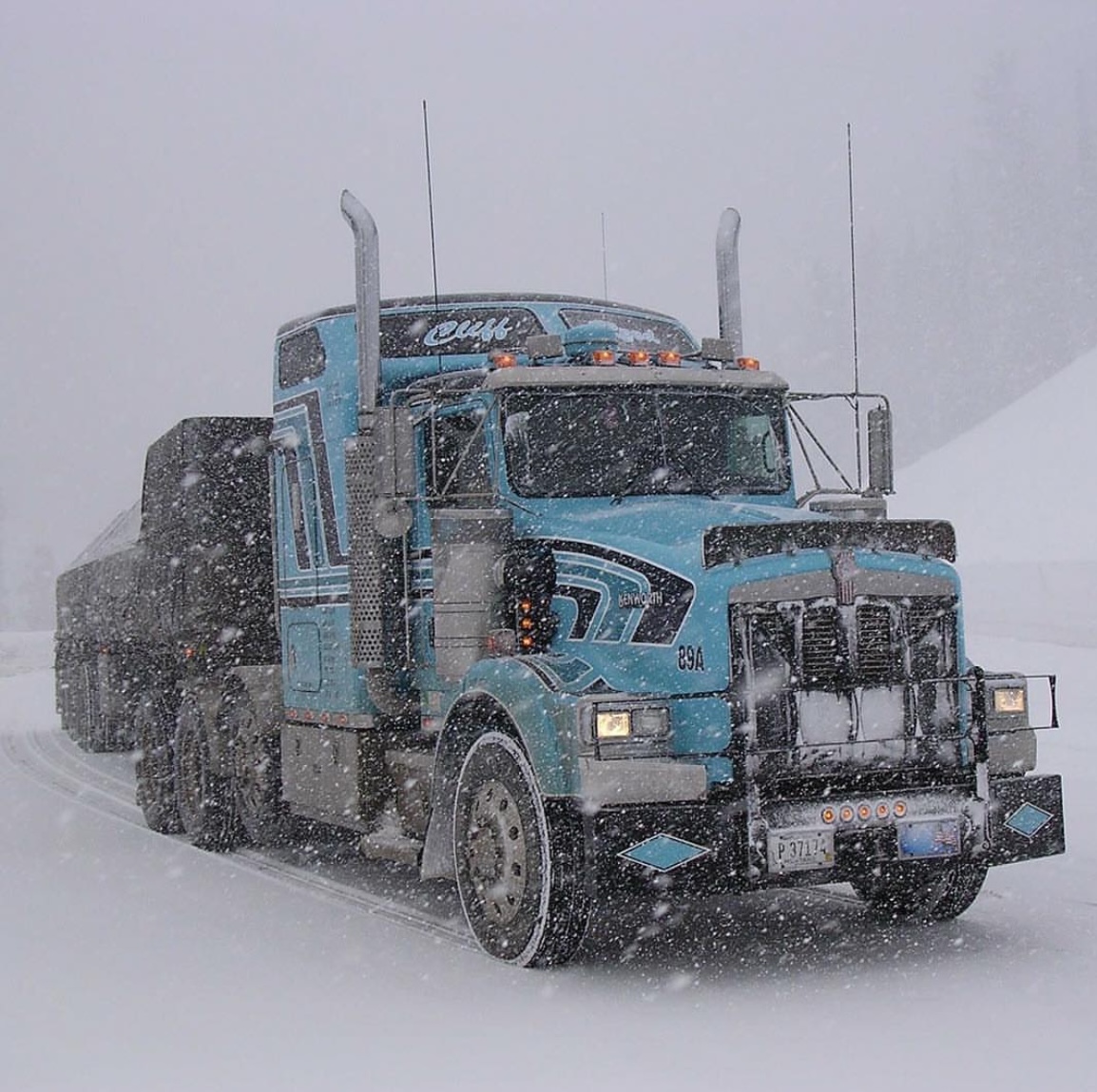

    Here you go. Stopped down toward the bottom of Lost Trail to take a leak this day. Notice how the trailer is loaded to max out the weight on the tractor. Notice how I have an axle in the air coming down the hill. Notice how there are no chains on the drives. It can be done if people are smart about it.
    Also on this day there was zero snow coming down on the Montana side until about 3/4 of a mile from the top.
    Anyway, you keep doing things your way. Nobody is going to care. But it doesn’t look well when you keep having solutions for problems that don’t exist for the people that do it every day.
    And about the brakes on the pup, that was because of the inner bridge on the 4-6 axle group. The back axle of the pup had more weight on it than the turntable. Instead of needlessly throwing 3 chains on the trailers it was easier and just as safe to close a valve for a few miles. Usually guys would do it leaving the yard and then stop a couple hours down the road and open it back up once they were over the hill.
